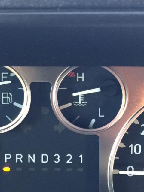

I've had the water pump changed, thermostat changed, ECT changed and my gauge still shows this all the time unless I see smoke coming out of the hood I'm not so worried about it.

That is about 220F on my scangauge, I know I have another 20 degrees or so to go before the car shuts off the A/C but in my mind when the A/C is shut off you are at the point where damage is happening or about to if not fixed now. I understand that these I-5's run hot and I understand that they run cleaner for emissions at higher temperatures but if I have a 190 degree thermostat then the cooling system should be able to keep it pretty close to that temperature, 200-205 max. There just isn't enough reserve cooling capacity for these motors to keep it at 205 degrees. I do not look forward to 100+ temps when summertime comes and I see the needle edging 230 in stop and go traffic, that may not be "too hot" but it will shorten component life.
My wife's stock, base H3 runs at half on the gauge, 205-210 all day long in any conditions. :/ Some people have all the luck but for the rest of us?
