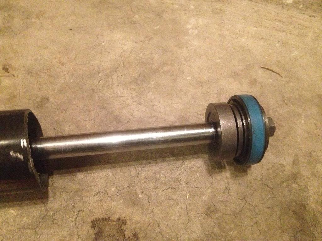

and the monotubes will outperform the oe adventure package shocks..
Monroe GT-Gas with exclusive Reflex Technology - YouTube
Am I going to have to cut open my old shocks and find the difference? So the monotubes are using cartridge dampening, nothing new there. I would bet your own money that the OEM is cartridge and not damping rods. Any difference between the two is probably in the washer stackup. I still think the Adventure valving was better but not perfect, needing more rebound damping and less high speed compression damping.
Please post pics after you open those up. TIA
Here is a picture of the rear shock internals. The retainer nut is loose now but it appears the rod end is peened over lightly so at the moment I can't get to the internals and shims. Maybe tomorrow.
