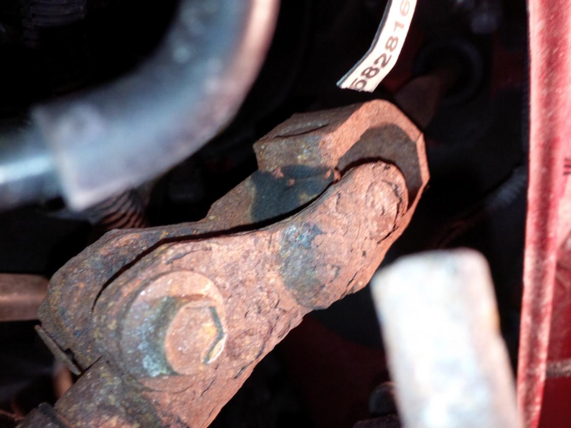

After removing the inner plastic fender, I found some aggressive stages of corrosion on some parts including the steering linkage. (images attached)
This will need cleaning and anti-rust painting. You will need a box of these to put the fender back in-->
