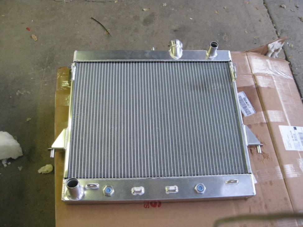

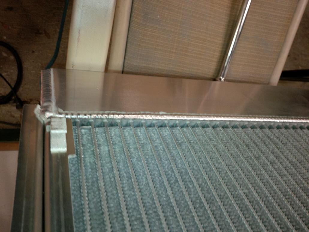

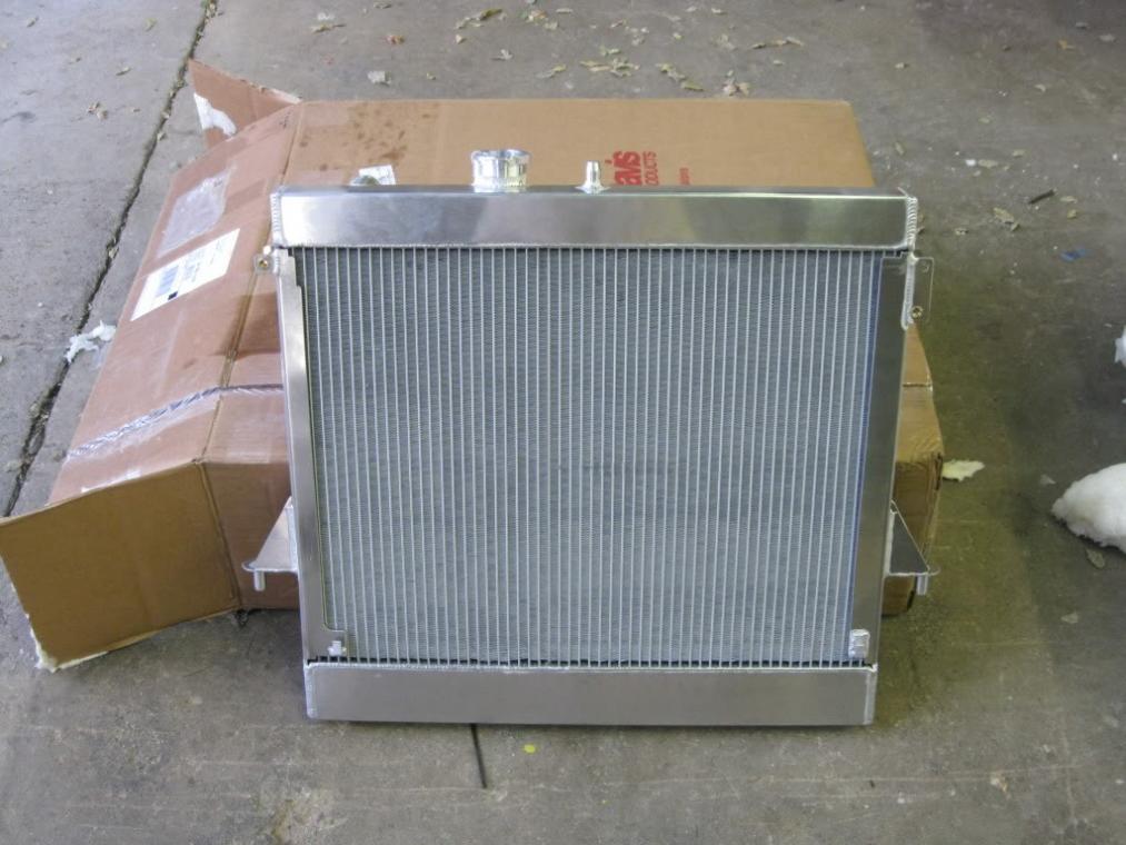

Just ordered a solid aluminum radiator from "Ron Davis Racing Products, Inc."
They are road proven in use and exact fit for the H3 and H3T ready to ship. Expensive but a good investment in safeguarding your engine and transmission. No more plastic radiator worry for my H3T.
Attached Thumbnails Mishimoto - aluminum performance radiators?-img_4093.jpg   Mishimoto - aluminum performance radiators?-img_4096.jpg

The Ron Davis Radiators POC below has H3 100% aluminum radiators ready to ship. The price is around $1000.00 shipped with the cap and transmission cooler fittings.
The fabrication craftsmanship is looks excellent near nuclear work quality. They have been making these 100% aluminum radiators a while for the Hummer H3's and the have had durability test operating time is the field in harsh environments.
I found a couple of other custom radiator manufacturers cheaper, but none have the vehicle field hours Ron Davis has with H3 radiator. They all need my old radiator shipped to them to use as a template to fabricate there product. I did promised one of them my old radiator anyway so one day we have a second source.
I'm taking pictures during the install to post later. While she's apart, I am restoring all the hoses, belt, and flushing the systems as the prior owner looks to have missed the routine radiator flushing by the brownish color of the drained coolant. Of note, the long lower hose at the engine block requires removing the left tire to reach the hose clamp through the fender well.

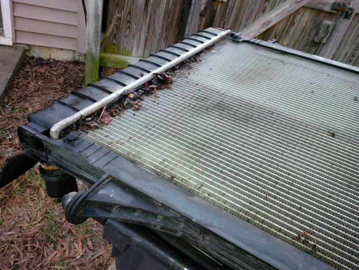

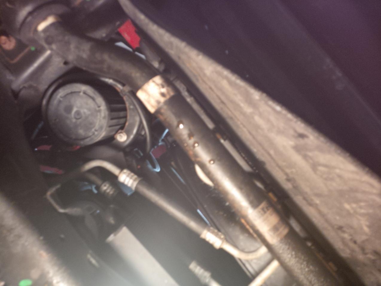

Discovery Note:
I was only getting a few drips telltale under her before I discovered the leak across the bottom radiator seal. (images attached)
Recommend leak inspection from time to time.

Here are my failure findings:
My radiator failed from corrosion with help from bio-foul (lots of bugs and dirt) debris trapped between the AC coil and radiator building up on the bottom plastic to metal joint ridge.
The Ron Davis design does not have the large bottom ridge like the plastic model to trap debris like this, but bugs still get into the coils. (see images)
*Recommend opening the hood and completing a low pressure fresh water flushing of the radiator coils to get road debris out.
Besides the attached images, here is a link to a video of my radiator and collection of dead bugs-->
Attached Thumbnails Mishimoto - aluminum performance radiators?-ridge-1.jpg   Mishimoto - aluminum performance radiators?-ridge-2.jpg
