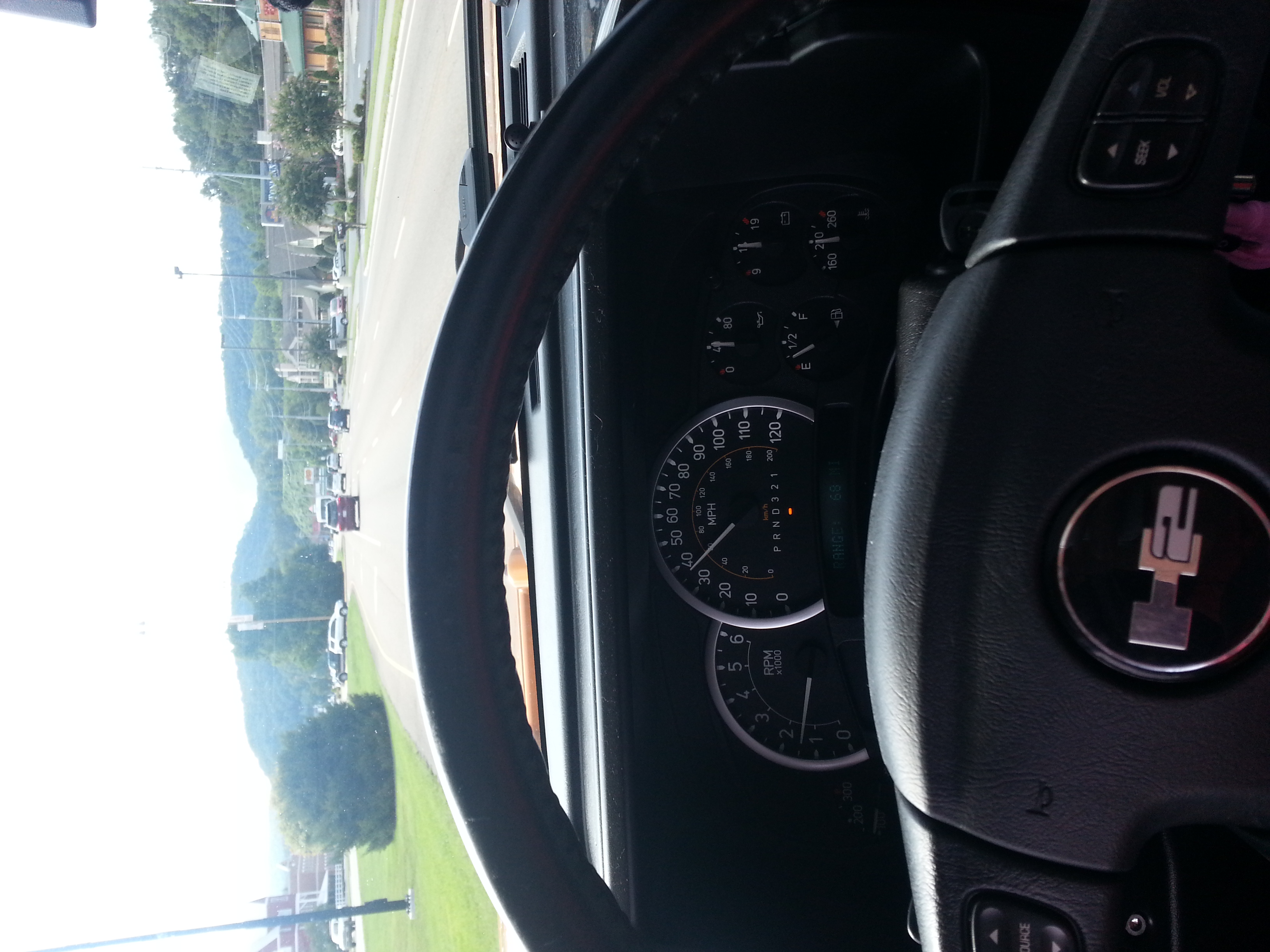

Off topic ... You guys are making me jealous with those 2008 dash pics .. Wish I could keep my 2006 with some 2008 interior
BTW mine att idle is always a little under the 12 mark then after passing the 1000 RPM Oil pressure increase . I guess this is normal
Here it is a pic of mine
Cond :
Outside Temp 80
Engine temp 205
transm temp 140
RPM 1500
Speed 35 mph
