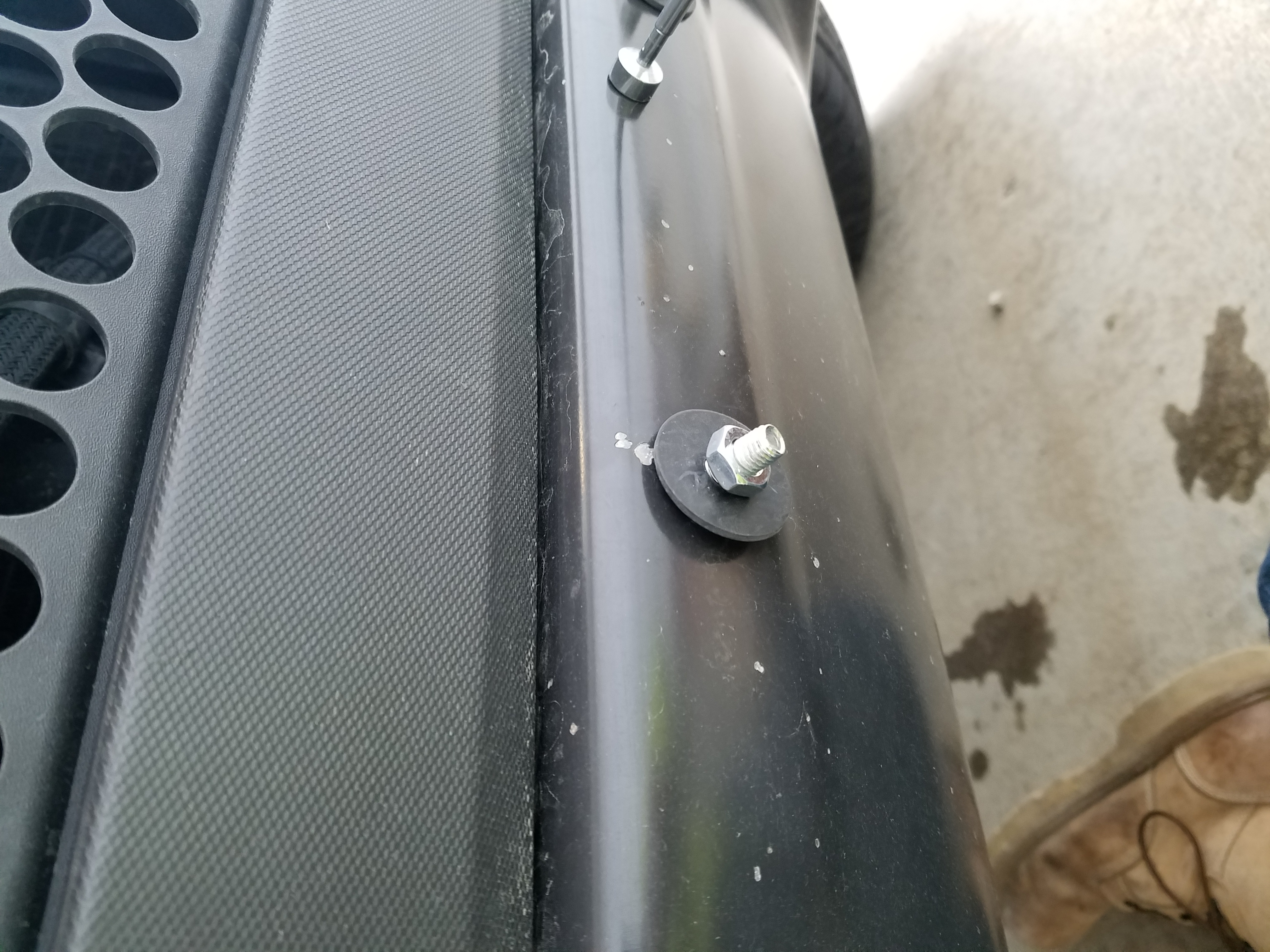

Using the front license plate holes on my H3, I was able to mount 2 KAWELL 18W LED pods. I am using an ANZO Wireless Remote and it has been working perfectly. My skid plate is corroded on so I was unable to easily remove it for rear access to the backside of my front bumper. I wanted this to be an easy project so I took my telescopic magnetic pole and pushed the bolt and a rubber washer through the back side and had it sticking out of the front. I held the bolt in place with pliers as I put on another rubber washer as well as the mounting bracket. I used a locking nut so it wouldn't back off due to vibrations. It was a pain to do without being able to put a wrench on the bolt but it was do-able. I ran the lights in parallel to the controller and wired it into channel 1. Zip tied it all off and it works perfectly.
