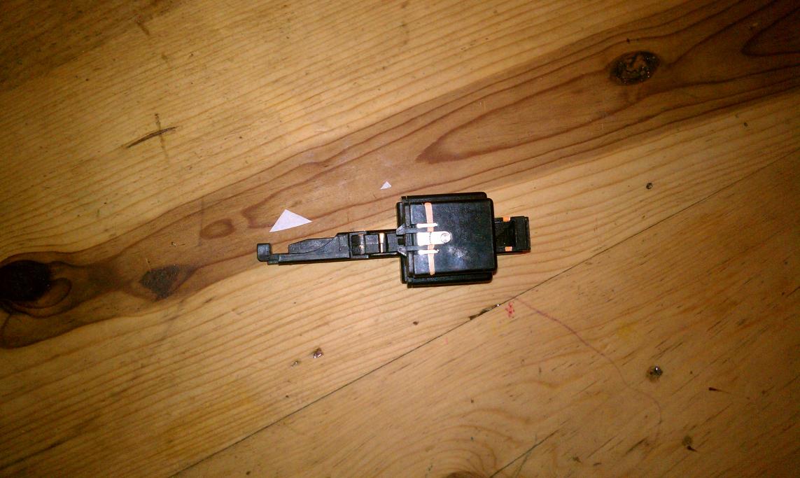

I got it apart and found this to be the problem, I disconected it and key came right out. Hope I do not need it.Key Stuck-ig-lock.jpg

Originally Posted by bigdog100
I got it apart and found this to be the problem, I disconected it and key came right out. Hope I do not need it.Attachment 4460
Looks like the key buzzer, ah, chime...

no I took it apart and it has a small actuator in it and spring, must be the key lock

any more pics,close up.
id like to know about anything that can be tossed! kill a future problem huh
drtom, when you take the cowling off and look at IG you will see where this actuator plugs in. I just used a screw driver and popped it out and took off the harness and all is good so far, it is not throwing codes.

ok,yeah im gonna have a look,maybe see,feel what it does with key in/turn huh
later
too cold to mess outside but from your pix and the manual,it looks like you could pull the key
ANYTIME!, like when running? if so,my dream come true, just like the good old days.
almost key free!

i got mine out,nothing changes! it must just have an effect ,IF something unique is changed. you must have a key,door sw,?? acting up.
the only time mine is activated is when the door is open.it can be felt cliking when the key is turned on,ONCE with the door closed,always with door open.
question is,why did yours hold the key??,mine never does. is your device bad?or have you just bypassed another problem?
also nothing ever moves,it just allows the plunger to move in. it does not actually move it.
??? a mysterious part, called "ignition lock cylinder control actuator"
oh, no i cannot pull the key in run mode,drat.
WELL,finally i simulated a bad one or no voltage applied. i pulled the conn. yes it locked my key!!. so yours is not getting volts,or it is bad itself. now im trying to find the volt source.
