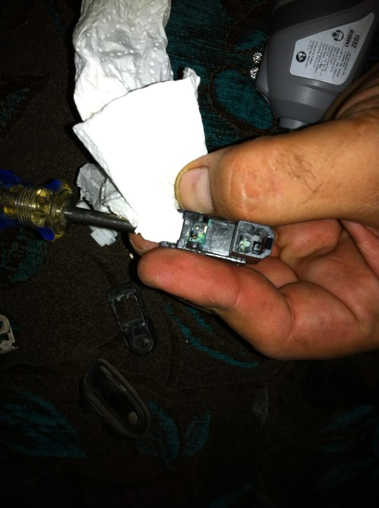

Hi and welcome to solve the problem behind cd /radio won't turn off automaticaly when opening the door and the key is out of ignition
this is due to bad oxidation in switch contact in the door panal so let's solve the problem

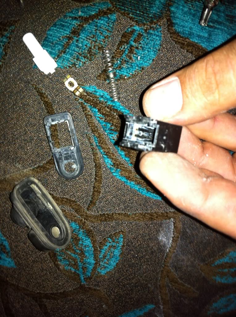

now you have the switch first remove the rubber cover
use - screw driver just remove the cover don't be hard these plastic cover are very easy to brake
the cover removed remove the metal bar next
now remove the button as you did in the cover
chick out for oxidation and use oxidation remover spray but dont forget the inside two metal
too much oxidation here

install back the button first then the metal
last thing re install the rubber cover and screw the bolt chick out if the key in ignition u must hear ding sound once the key removed CD player will turn off and the dome will light any time you open a door
thanks and regards sorry if u found grammatical mistakes i am not native speaker
