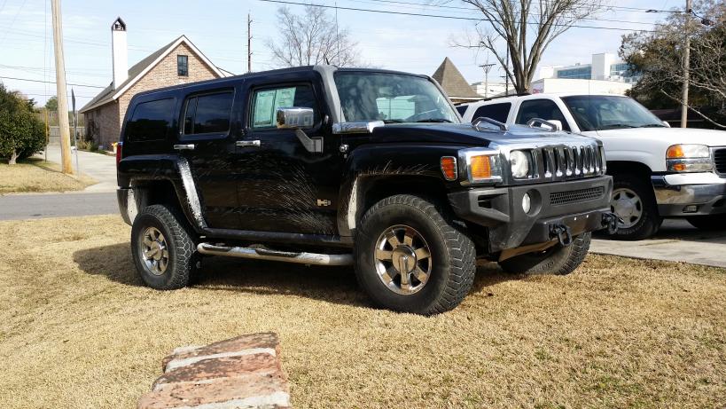

So Im new to the site, I just bought a black h3 and want to do a few things to it, money is not to big of an issue but im not a millionare lol.
Things i have in mind are : Lift - exhaust- tires- screen- push to start etc.
And ideas/what to do/what not to do
Thanks
Attached Thumbnails just bought an h3, I want to make it a beast: lift, screen,exhaust etc. any ideas?-20140117_104641.jpg

Just a thought, I noticed your front exterior A post covers are dull from the sun. I had the exact same problem.
I removed them (which is very easy, 2 Phillips head screws on each and pull off I believe) and sanded them. Then hit them with black paint.
Almost as good as new.

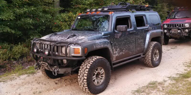

There are basically 2 lifts that are readily available for H3's, Rancho and Rough Country. Both are 4" lifts and run about $2500 for the parts and by the time you get new shocks and wheels with a different backspace, you'll spend another $1000 to $1500.
The first thing I would do is remove the side steps, unless some girl makes you keep them on.
Mine has just the torsion bar adjustment and the 1" body lift, on 315/75/16 Duratrac tires.
