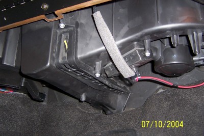

To answer the question that I know. The early production run of the 2003 Hummers had cabin filters. They were phased out with the underhood lights, hood prop rod, and tan drivers airbag, among other items.

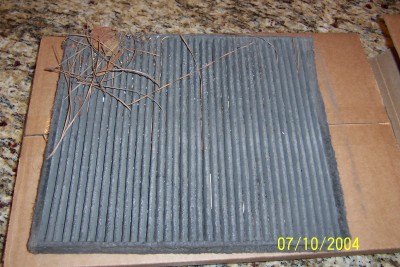

The filter is located under the door with the yellow hash mark on it in the first picture. It has 2 7mm screws and the door drops down to expose the filter. I included the other 2 pictures as a refference why GM would seal a system when mine was this dirty in 1 year.
