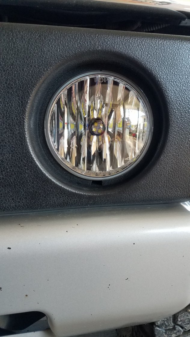

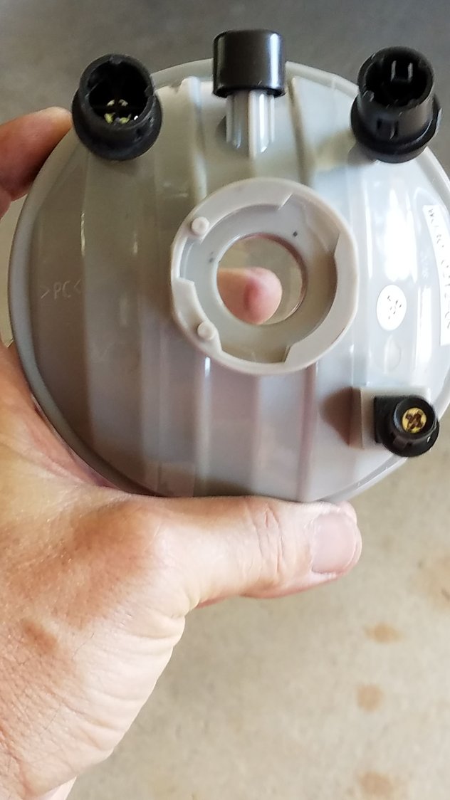

I found some DRL's with the same reflector as the headlights so I thought I'ed give them a try,

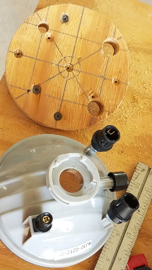

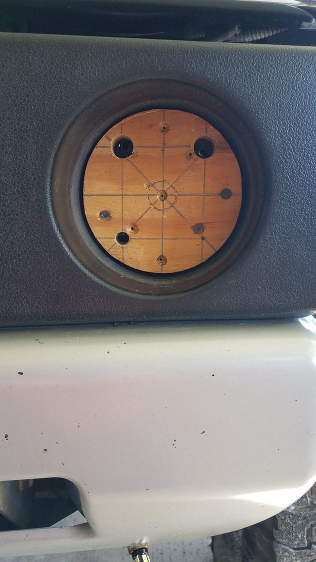

They came with some push in fittings and an adjuster so I made a template for the new lights and used the mounting screws from the old lights to fasten the template to the bumper while I drilled the new holes.
This is the new lights;
The template
The template with the mounting bolts
Template mounted in light pocket
The new light on the right with a LED bulb in the old light on the left
The old light with the OEM bulb on the left and the new fixture on the right with LED bulb
Both new lights with LED bulbs installed
