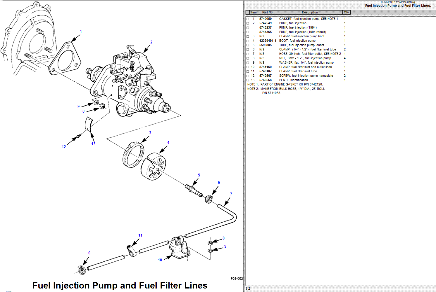

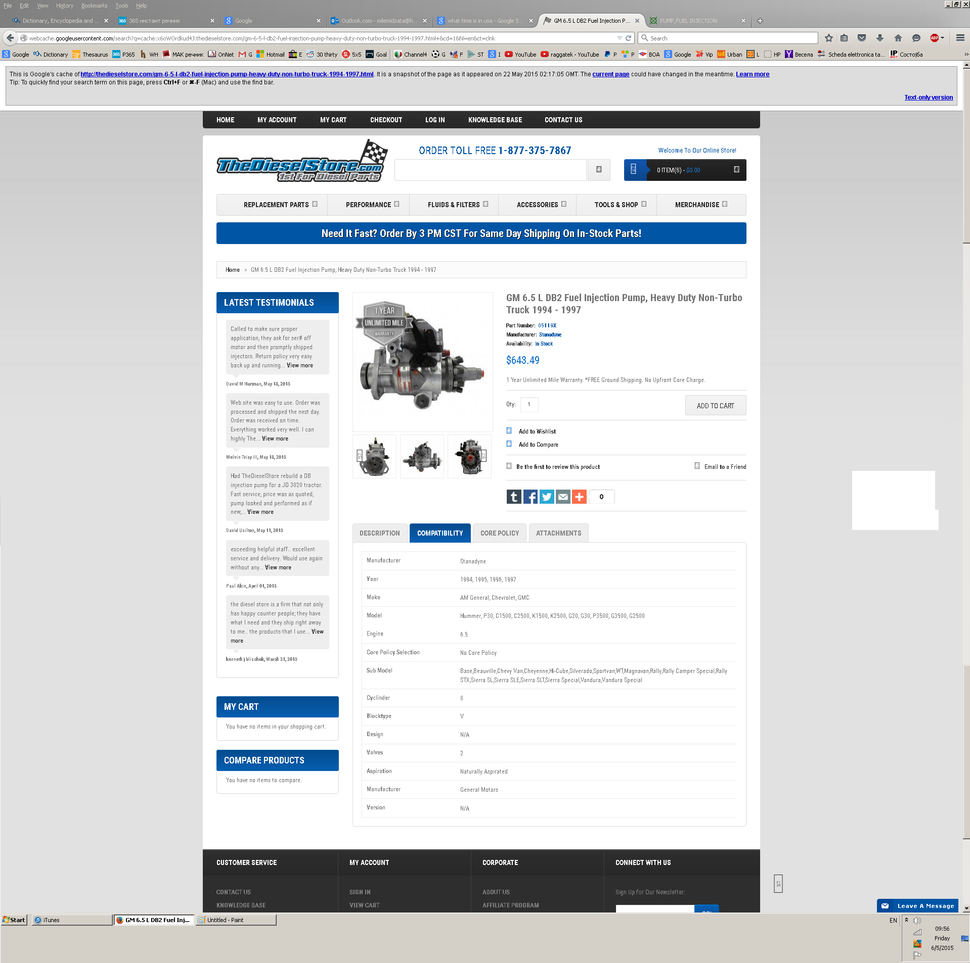

We've found a good deal for the injector pump priced at 650USD which is manufactured by Stanadyne at one web site. We're not sure if we're allowed to post links in the topic, so we've included a screenshots in the attachment section. Also we've included the pump's diagram which we've got from one nice gentlemen who revealed us some valuable information.

Attached Thumbnails Injector pump for Hummer H1 1994-injector-pump-hummer-h1-description.png   Injector pump for Hummer H1 1994-injector-pump-hummer-h1-pictures.png   Injector pump for Hummer H1 1994-94-fuel-injection-pump-diagram.gif
