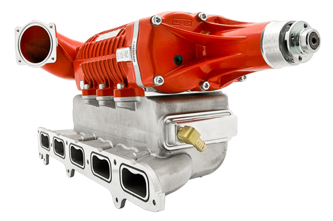

dohmn8r's Avatar
Posts: 45
What about HARROP | Superchargers instead? They are located in Australia.
I'm curious what numbers they get with this setup.
Harrop HTV1320 (80ci/ rev – 1320cc/ rev) supercharger assembly using Eaton TVS™ rotors.
Intercooled manifold and tensioner bracket
Available for H3 Hummer I-5 GM Colorado / Canyon Pick-up
12 month/20,000km warranty *conditions apply
