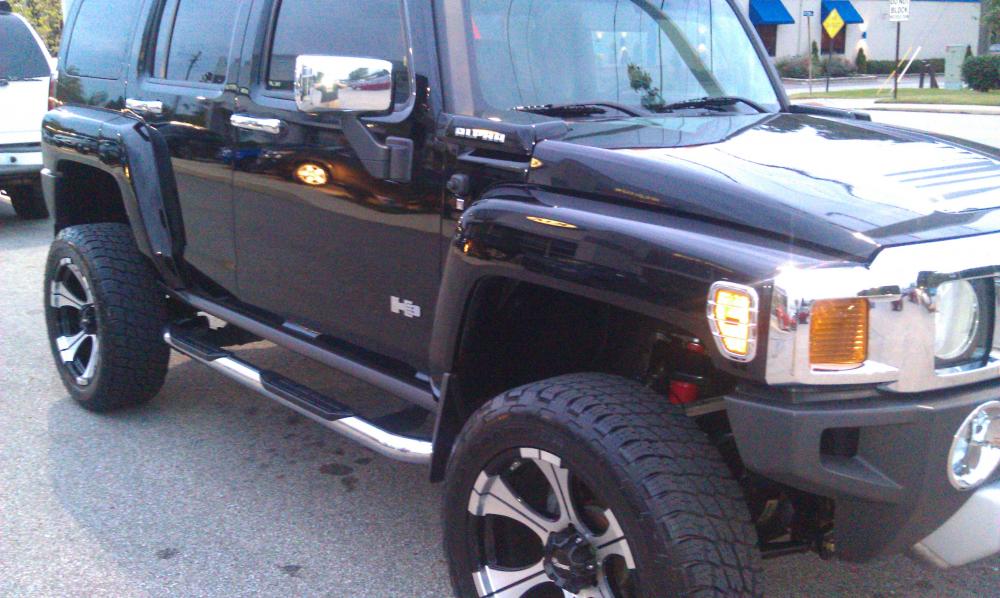

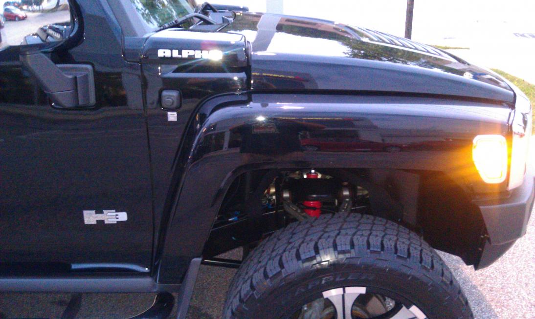

I know this is a h2 but I want to set up my h3 alpha to look like this with ride height and wheels, does anyone have any info on this hummer? I have the rancho lift kit on mine. what all would I have to do to achieve this look?

To each his own... Seems like a waste of a Hummer to me, but my thought is that you would first have to remove the Rancho lift and order a lowering kit. Then add some fender flates.

Based off the way the front wheels are tilted, I would tell you it looks like it has air bags installed. I don't know if there is a direct bolt on kit for H3's, but a universal kit probably could be adapted if you have welding skills. You would basically be removing the torsion bar set up and replacing it with bags...

nix the lift kit, get some dropped spindles and coil overs. probably need a modified 4 link in the rear too. loose the steps and go with a molded running board / fender flare kit.
i don't think the h2 in that picture has dropped spindles and that's why there's so much negative camber.
