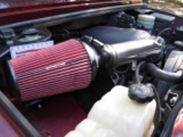

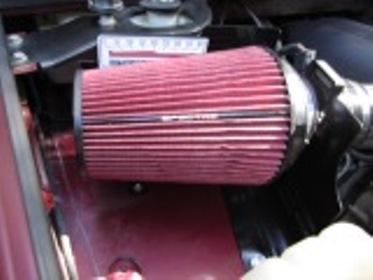

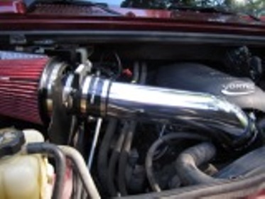

Hey, just want to share with everyone that you can by an Intake at Advance Auto Parts that is not made for a Hummer, but with a little mods, you can make it work. This is a very good intake and it only cost 139.00. All you need to do is modify the mounding brace. I have attached some pic's of it installed on my hummer with the part numer of the box.
Pic may not be great seeing how it will not let me up load bigger pic, Thanks

What modifications did you make to the bracket to get it to work?

This won't hurtbthe engine in any way or give you engine codes from pressure issues? Is this safe to do on a 2007 model h2?
Old Aug 22, 2011 | 11:57 AM
chrisstaton's Avatar
Joined: Dec 2010
Posts: 23
that one is all good as long as you dont have a throttle body spacer. if you do, the only one you can use is the airaid modular intake tube
