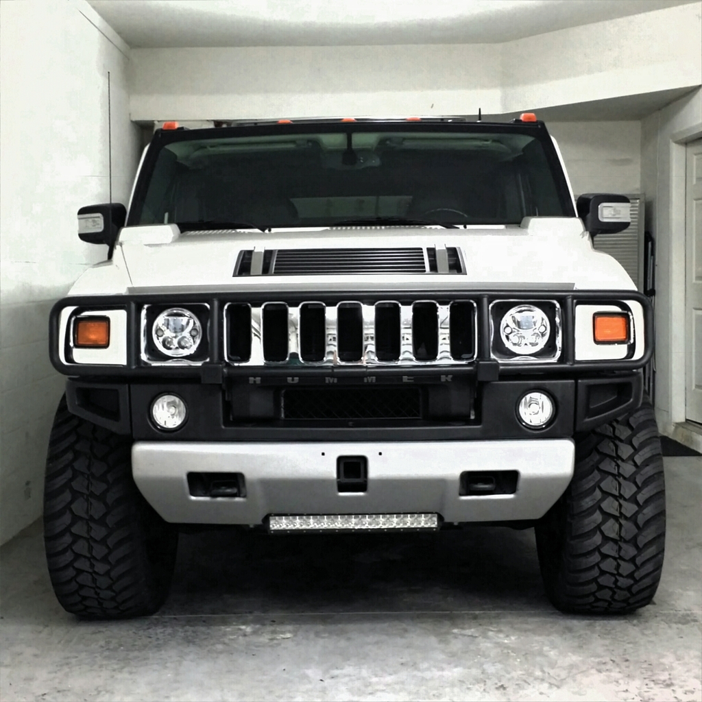

Video is in my photobucket account but I just can't get it to work. Maybe your computers are faster. Here's a pic from my account, it will provide link to account.
