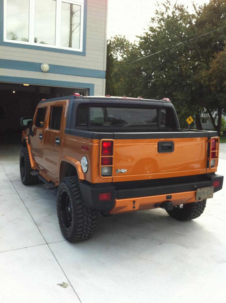

the lic. plate light wire runs out the bumper & along the carrier to the center of the spare tire, I just unclipped the wire ties & bundled up the wire behind the plastic bumper cover... the newer style carriers the tow hooks are part of the assembly, unlike the '03 which you could reuse the hook without the carrier on.. & if you have an SUT like me, you need to figure out a new place to mount your licence plate & rig up the light some how

Thanks Thunder Cat, Nice Looking Ride by the way! I Don't have the SUT but mine has a place to put the license plate on the back of the Hatch, just need to get the accessories to do it!
