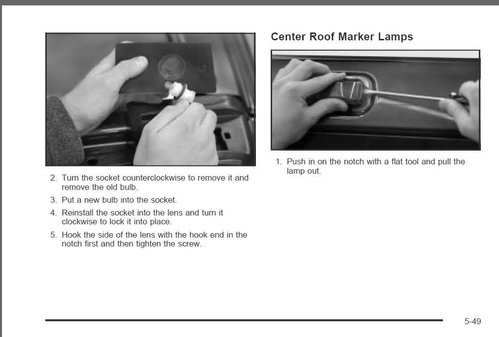

2 of my 3 running lights are out above the rear window.I poked and pryed at them a little but didnt want to break them.They just need new bulbs.any help?thanks.

There is a clip holding in the light fixtures. They pop out from the outside. I think the clip is on the right as you at them.

use a small flat screwdriver and push on the right hand side in toward the light...they will pop off.
