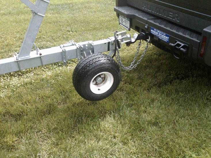

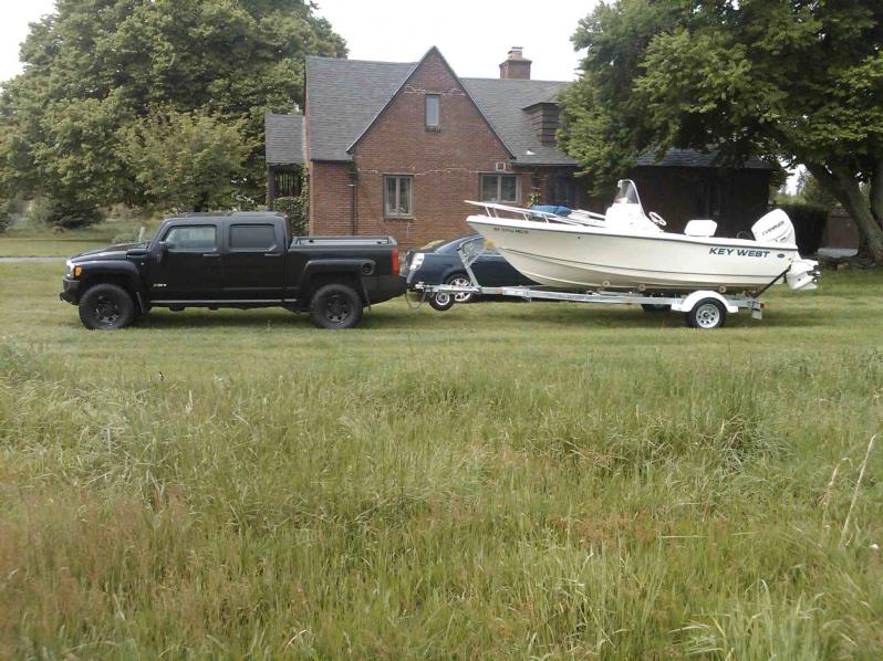

I am using only about 1" of drop. I launch my 18' boat across the beach here where we have about a 6' tide. I have mounted a 3rd wheel on the tongue by using a spare hub and tire carrier and mounting it upside down and installing a golf cart wheel. The high tongue helps load the boat and gives my third wheel clearance. My method is as follows for getting the boat in.
I crank the boat up on the trailer (can't back in far enough to float on) leaving it about 1' short so there is almost no tongue weight.
Then I lift the trailer off the ball and set it down on the third wheel.
I drive the truck up the beach to the hard dirt above the storm tide line.
Then I attach as many of the five 25' chains I carry and the trailer pulls right up.
Then I lift it back on the ball (remember no tongue wt) and crank up the boat the rest of the way.
I did this last year with a Land Rover Discovery II and this boat. This year the H3T might pull it up without disconnecting but you need the option for when the beach is very soft, the tide is rising and a storm is coming.
Attached Thumbnails Hitch Receiver Height?-hummerandboattopost.jpg   Hitch Receiver Height?-hummerandboatclosetopost.jpg
