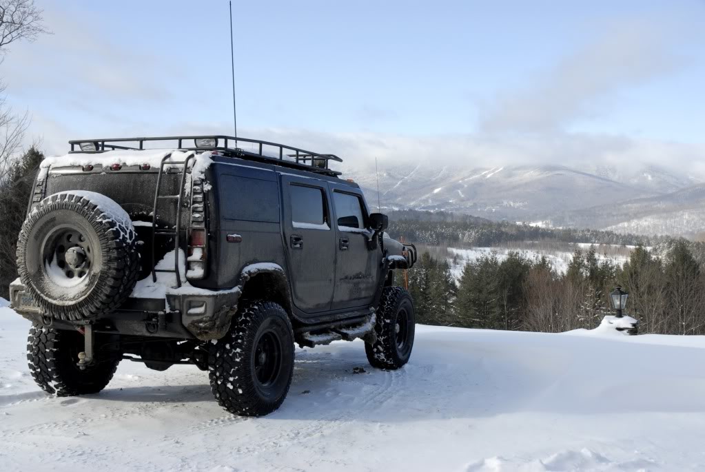

my h2 has a 4 inch rancho lift kit with 38 inch pro comp tires (38 50x14 50R 18LT). Off road it amazing but on road its a little to bouncy. Would anybody know of anyways of how to fix the bouncyness and body movement without lowering it? Also if i were to lower it how low could i drop it without causing wheel rub or any other damage of that sort?
heres a pic

Great pic composition and a nice looking H2.
