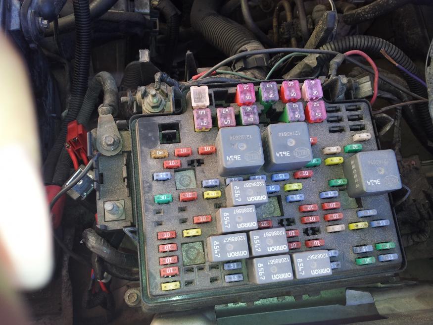

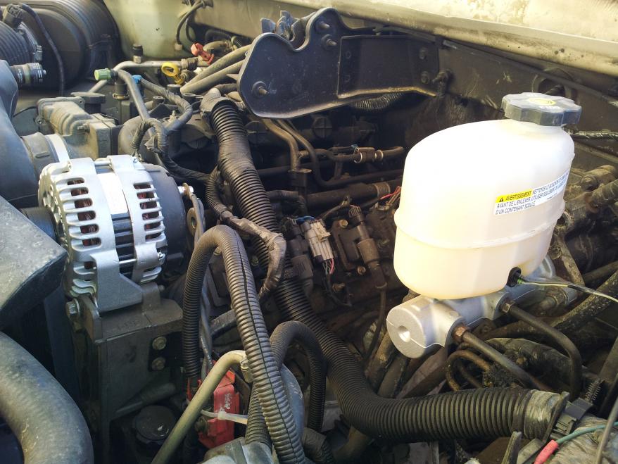

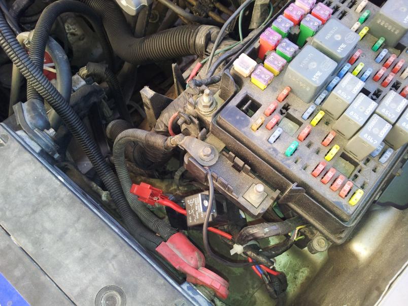

finally after 2 months,my car ready for test drive. the cause for the delay was i'm ask the mechanic to look for used parts,obviously it is the cheapest option. few parts still missing : fuse junction box cover and engine ecu cover. anybody know where can i get those covers?
earlier i mentioned the coz of the fire is the battery,but well it is comin from a faulty alternator. Mechanic tested the alternator and found it doesn't stop charging even-thou the battery is full. so i get a new alternator,new brake master cylinder and new engine bay hood steel cable. the rest is used item.

Looks like your Mechanic did a great job. Congratulations on getting it back together.
look like he is. the engine wiring harness replaced completely and i know this require a macgyver type of skill huh...

Originally Posted by ak47dennis
Did you ever determine what caused the fire?
according to him alternator was the culprit coz it keeping on charging so the battery get overheat ( DYR CELL TYPE ) and exploded, I CAN SEE A HUGE BLAST MARK ON THE SIDE OF THE BATTERY.
