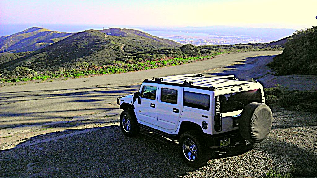

Rims are 20x10 Mazzi, tires are 325/60/20 Nitto Terra Grappler.

Here's side view
