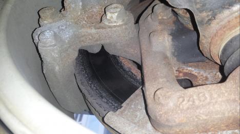

Thanks for all the response, really gives me some ideas on what to do next. I crawled underneath to take a look, and I can see where the rotor is scraping the caliper, but the brake lines and everything else seems OK for now. I could see replacing rotors and pads, but everything else seems like the dealer is trying to make money. Here's a pic, what do you think?

Old Sep 18, 2014 | 07:12 PM
Posts: 9,043
If they can predict when a brake calipers are "about to seize" then they should be able to jump into the business of predicting the future lotto numbers, or bringing back the dead. I've had more than on car 40+ years old, corroded calipers, no seizing. Like bunger said, instead of taking a bit of time to clean them up and carefully inspect, just throw your $$ at some new parts and send you on your way.
Go to a reputable local brake shop.
Happens all the time, usually with vehicles that are not driven all the time. The caliper pistons do not move as they did when they were manufactured. Looking at the brake pad wear will indicate the problem: inboard pad worn more than the outer pad, indicates a brake caliper (most common) or brake hose (not so common) issue.
To check if there is a caliper about to seize: pry back the caliper piston with a screwdriver, or remove and compress the caliper piston with a pair of slip joint pliers. If the piston doesn't move, its "about to seize"!
30+ years in automotive repair, the same occurs to this day.
BTW, I had a caliper on my rig, that was "about to seize", would not compress, so I replaced it!
When you depress the brake pedal, the brake caliper piston pushes the inboard pad against the brake rotor, and pulls the outboard pad against the brake rotor, when you release the brake pedal, the brake pads should release from the brake rotor, if not, you will have a brake drag.
Back to the op, I replaced all 4 brake rotors (cross drilled /slotted) front and rear brake pads with ceramic brake pads, Both front brake calipers(loaded with pads & hardware) for ------->
