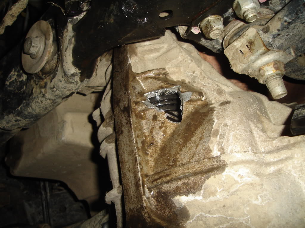

This was the latest mishap from the tires. It is not a good sound when you hear your front differential just explode into pieces. It was real bad and then all of a sudden it got quiet again. Another bad sign... I still have the spider gear as a little souvenir.
