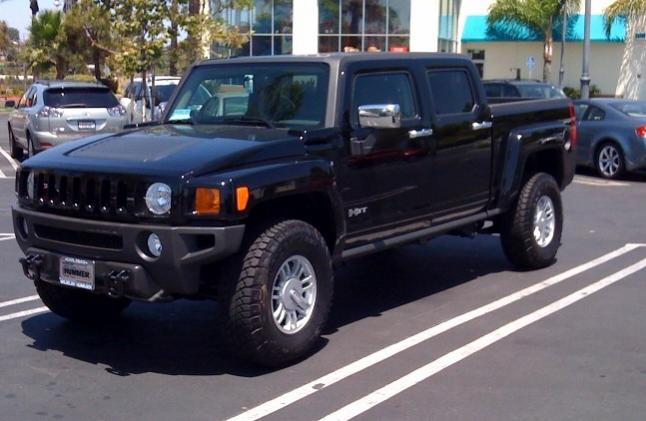

a before pic
Attached Thumbnails h3t alpha mods/tires-photo.jpg

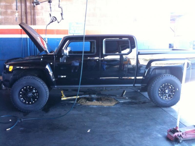

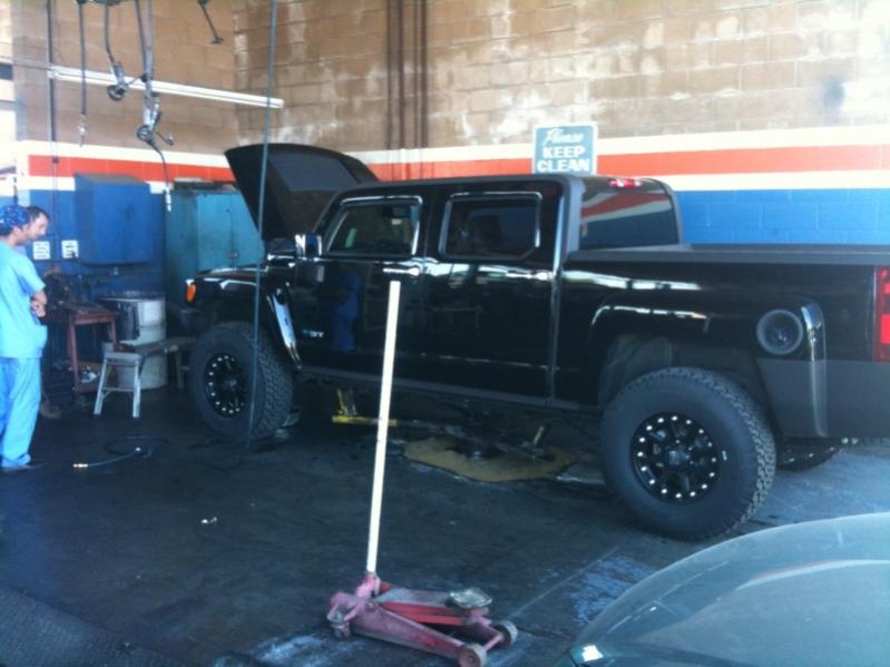

Well I got the truck level with the T-bar and threw on the Additcts/BFGs. But when I was getting the alignment done, the guys brought me back and showed me steering fluid leaking down. So then straight to a GM dealership and replacement of the steering fluid pump/reservoir/tubing. All warranty but all very frustrating. Anyone have trouble with their steering fluid pump/reservoir yet?
Attached Thumbnails h3t alpha mods/tires-photo-3.jpg   h3t alpha mods/tires-photo.jpg
