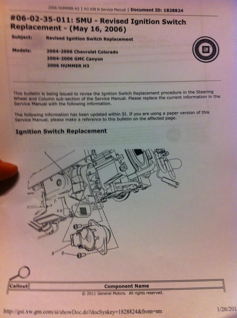

please see pic attached . Many h3 2006 owners are replacing their ignition switch which triggers the Passlock to become active for 10 minutes.
