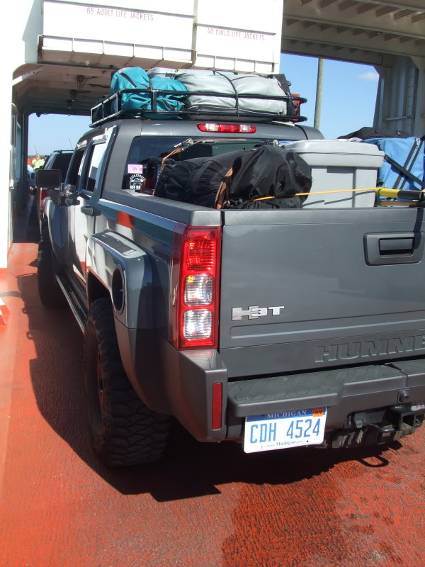

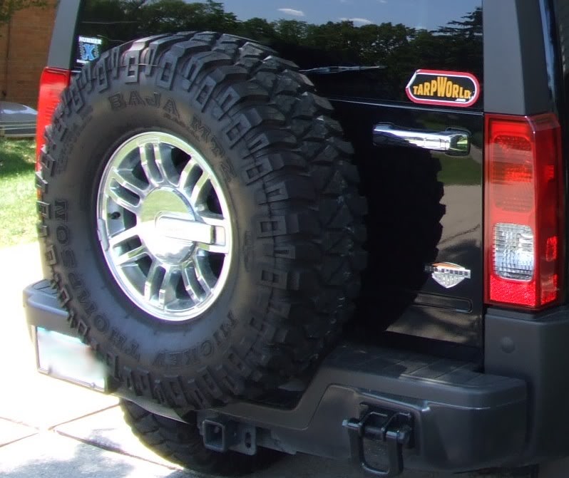

NOPE, 2 different tail light assemblies:
