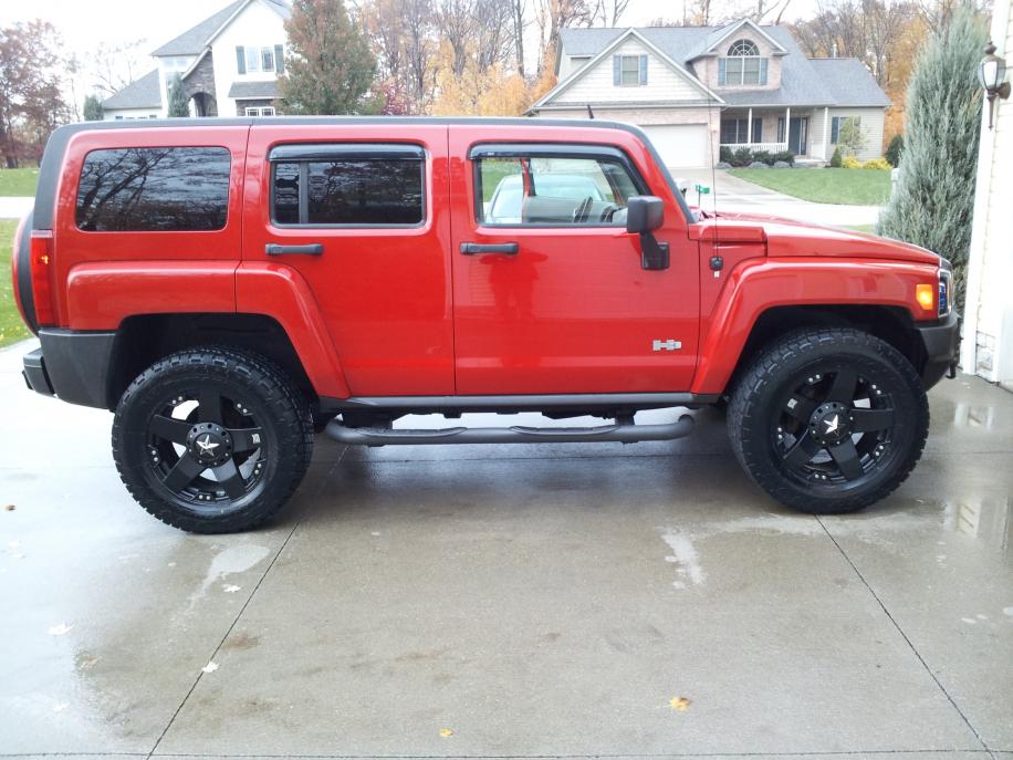

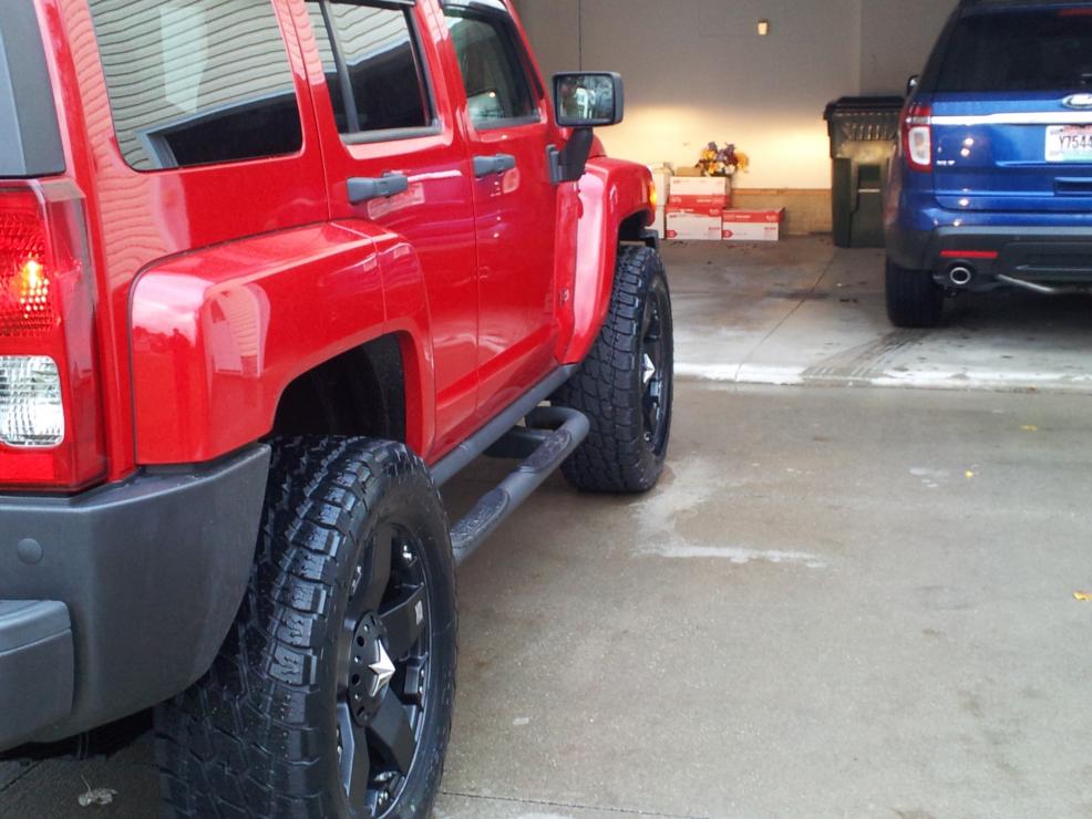

2008 Red H3, 99,104 miles. Installed today - 20", +10 offset, KMC Rockstar XD 775 matte black rims, with Nitto Terra Grappler 295/60/20. 34.45" OD, and 12.3" wide. Took some pics from a few angels, but not sure my camera work does the truck justice. These give my H3 a totally new look, clean and aggressive stance, and they ride perfectly. Breaking distance was fine in the cold rain today in NE Ohio. No rubbing whatsoever. Really fills out the wheel wells. While it was a little pricey, I am extremely happy with the result. Hope these tires last until 150k miles!

That is a perfect tire/rim set up!! Did you crank the front torsion bars yet?? Looks sweet, I might have to copy you!!

Thank you. Did not adjust the torsion bars; everything fits just fine with no suspension changes.

nice, that black on the red really stands out..
If you go offroading just be really carefull thats a lot of rim..
