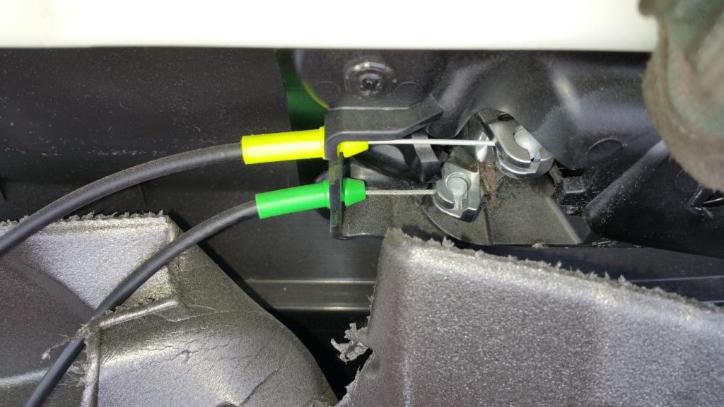

So I was right. I took off the door panel and saw this. That round head broke apart from wire.
I there any place I can get just this wire?

When you see what is wrong and need a part, go to any online GM parts seller and do a search for your year and model.
I did tried to find this wire, but couldn't find. I can get other part except for the number 8 and 9 from 1st image that I got from one of the GM site.

The parts you reference (#8 and #9) are NLA from GM. You will need to search the wrecking yards for them. Chances are you'll find them there.

Contact a dealership parts department and tell them what you need. Ev give them the diagram #. They can cross reference the pt# with other GM parts. Ask them to give you a price and the pt#. Once you have the pt# find it cheaper online.
GM likes to use common parts from other vehicles for items like that. Chances are there are several other pt#s that will work.

I've already checked with them n they are saying latch cable comes with lock n its $250 + tax.
Stupid ball n cable.

If theres enough length left would a cable barrel nut work on the end of it? Dont know if you've fixed this yet or not but just a thought and/or idea for someone later on
