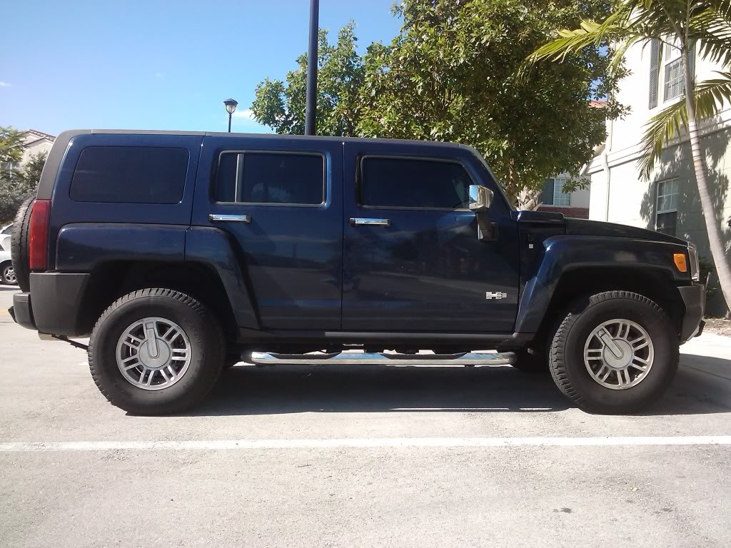

well.... this is what i did.
I lowered it my car with ground force kit just the rear 2".. but it was too much. So thanks to ur advice I lowered the front just about 1 cranked to the other side. so the meausures are.
Rear: from the wheel to the fender 25 1/2
front: from the wheel to the fender 24 1/2
I Will post pics tomorrow.

Old Nov 15, 2010 | 12:40 PM
maoelchurro's Avatar
Joined: Nov 2010
Posts: 6
From: Miramar,FL
