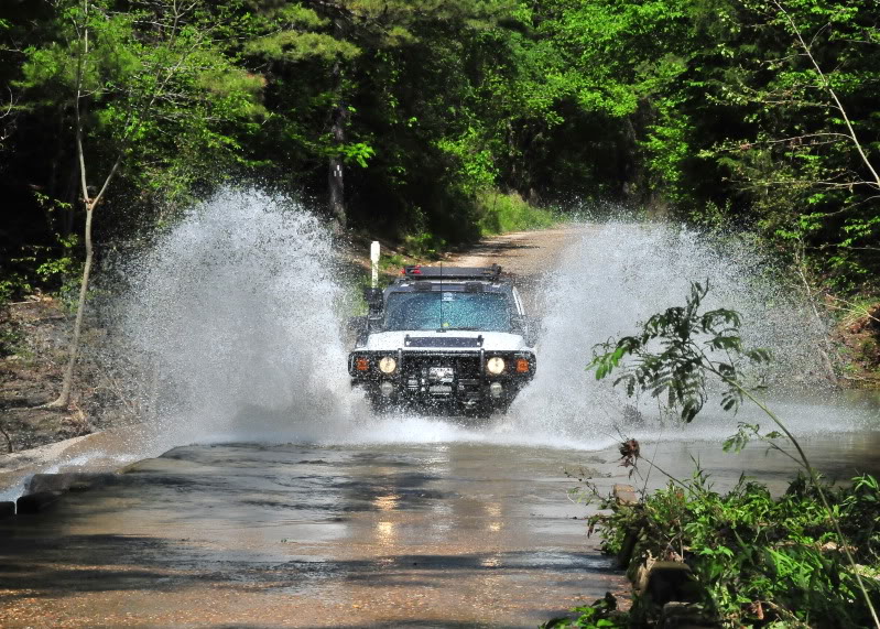

My Alpha with gear and skids, beefed up UCP and rock rails, brush guard and winch weighs in at a hefty 6080 lbs. The brakes seem adequate to me but I don't run up on things before jamming on the brakes. Sure there will be sudden instances but I feel like it would throw me thru the windshield without my seat belt on if I really jam them on. I have hit them hard a few times but the anti-lock works and it hunkers down pretty quick without tire skid.
If you really think you have an issue you should have the brake pump checked or like someone else suggested, brake earlier and leave more room between you and the vehicle in front. Worn pads will take more pedal travel in some cases. Sounds like you brake hard alot. You could have glazed over the pads by overheating them frequently and replacement would be the best option with a slight turn of the rotors to take any glaze or grooves off of them.
Drilled and slotted rotors have less surface area for the pads to contact.
My other vehicle is a Dodge Cummins 3/4 ton and I tow alot. I get used to the hang back, let people swerve in front of me, let off the throttle and only use the brakes to come to a complete stop whenever possible. Pads last longer and I still get to where I am going even if it is a few car links back.
The H3 is a heavy vehicle, unlike a sports car!
Instead of slotted and grooved rotors just cool your brakes off more often, of course they don't work so great right after doing this until they dry some.
