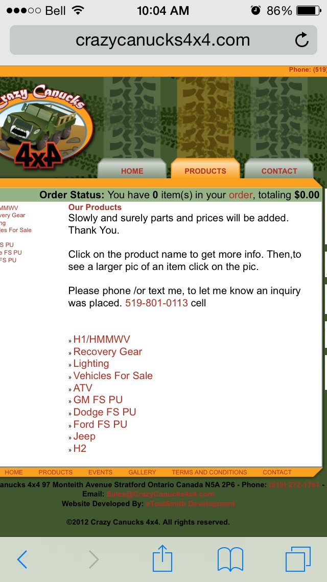

I just saw a similar post on a different forum. Canadian hummer club. There is a guy named roy. That has just started making the bushings and sells them. It is one of the top threads in the h2 section. If you want to see what it involves. Sorry Don't know how to post links.

I took a screen shot.

I hit their website as I was interested as well but there's only 2 H2 products, neither are those specific bushings.
