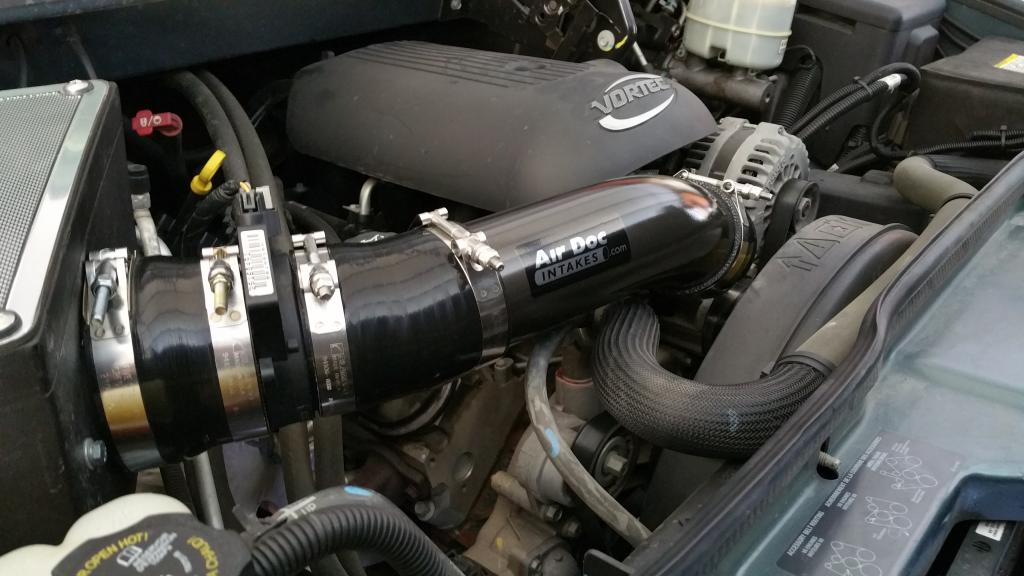

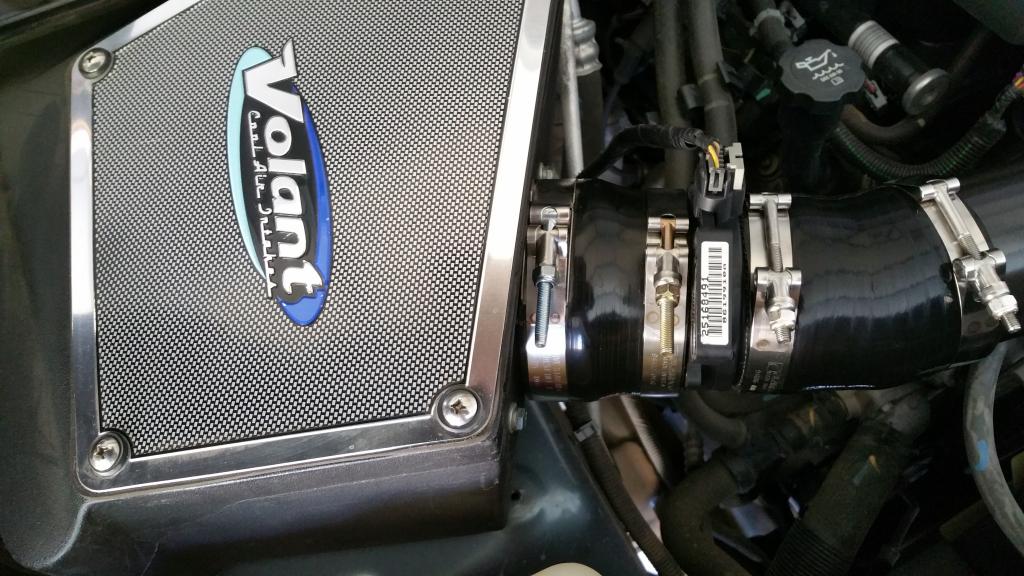

I prefer an AirDoc tube mated to a Volant intake, filter, and pre-filter.

Nice. How does your system compare to the K&N? Only thing about the K&N that seems problematic is that its not a sealed system and it relies on the hood to create the seal. It's also really expensive for just plastic molded parts.
Volant seems nice, totally sealed. Then I was looking at AEM's CAI dry filter setup...ugh, what to do.
I just want the best HP and MPG gains I can get.

Honestly you aren't going to get much performance from an intake, maybe some hp with a tune.
I installed the Volant because I couldn't stand how difficult it was to get the factory lid on and off. Plus I wanted a re-usable filter. This setup with the Volant pre-filter catches everything even in dusty Arizona. I eventually added the Air Doc to get rid of the resonator and have a nice smooth flow of air to the engine. The Air Doc does have to be trimmed down on both sides to work with the Volant box because the box sits closer to the engine than the stock setup.
Volant also brings in air from the factory fender vent which I like. I have never and will never install an intake which seals to the hood.
