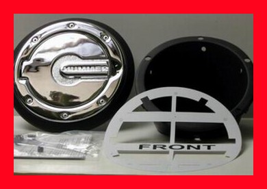

We bought a H3 recently and she wants to add the chrome fuel door. We bought a gently used GM factory chrome door, but it doesn't have anything else with it (seems like there should be a ring). Are we missing a piece? Also, I was reading the installation instructions in the FAQ section and was wondering if I would really need to drill into the panel? Sorry if this question has been asked already. Thanks in advance for any responses.

There should be a paper template to show where to drill the holes. You can probable make your own my laying a piece of paper over the back of the door and marking the paper for the holes. Careful when you drill. So the door will be strait. Use the correct size drill bit so the holes wont be too big.
There is a small black trim ring that I thought was part of the door.

Besides the template, there should also be 6 compression type nuts that you press into the holes you have to drill. This is what holds the fuel door in place. If you can't get those nuts from the dealer, the fuel door can't be mounted.

There's also the black, plastic funnel shaped cap surround that replaces the stock piece.

Thanks for the replies. It looks like we are missing a couple parts so I'll just order a new assembly. We basically have the chrome door and the screws in it. Thanks again for the help.
