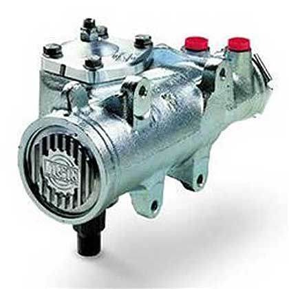

the AGR Box is what you need.
H2 SB2 Series Power Steering Box From AGR 264352

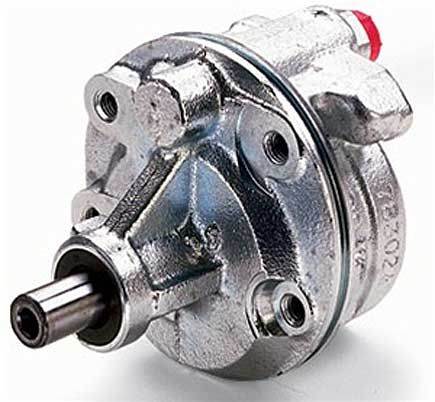

while you're at it you might as well get the H2 Power Steering Super Pump by AGR 807256 for complete tight tolerance
Hummer H2 Power Steering Super Pump by AGR 807256: Hummer Parts Club

@alarmy thanks . It seems a little pricy. Do you know what would be the advantage going with the AGR . Other than being Hd is there a difference how the truck handle . I agree in replacing also the pump

hi H2Miami, the AGR box is basicly designed to go with bigger heavy tires but is also used for H2 standard tires hence, HD components go into the manufacturing of their box and pump and equally resulting in long service life.
a key fector to acheaving the AGR long lasting box and pump without any issues is proper installation as per AGR recommendation and use of quality power steering fluid hence, a number of people overlook this area and get it wrong resulting in issues.

hi H2Miami, i have invested in the AGR HD Rock Ram Steering System 364351K07 Hummer H2 Heavy Duty Rock Ram Steering System from AGR 364351K07: Hummer Parts Club some time ago but have not had the time to installing it yet, however i will be taking time off from work very soon to finally embark on this project and shall report on performance.
