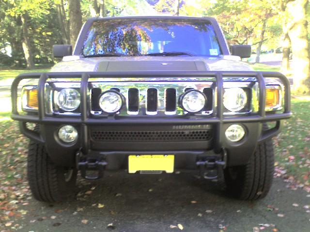

Also any ideas on the best grille guard for function and not just looks?

When your current tires wear out, get Michelin LTX highway or all-season tires in 265. I picked up 2 mpg on our motorhome running them (205 size).
My wife has successfully tested the SMA brush guard, let's just say that it's Nissan proof! LOL
