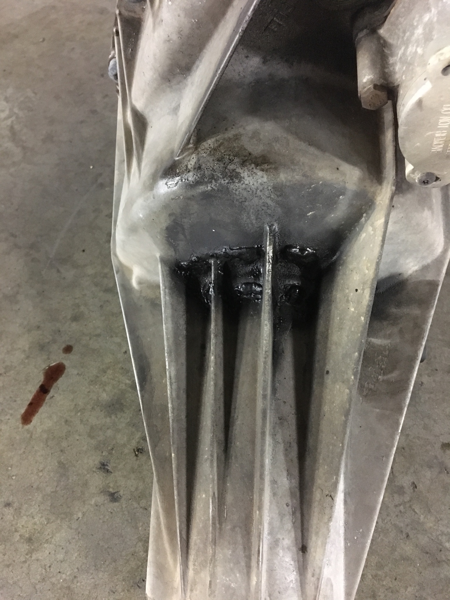

Thanks Phil I appreciate the compliment! I guess I'll never really know for sure. Someone sure must've towed something pretty heavy to crack that transfer case the way it was. I have attached a picture of it.
