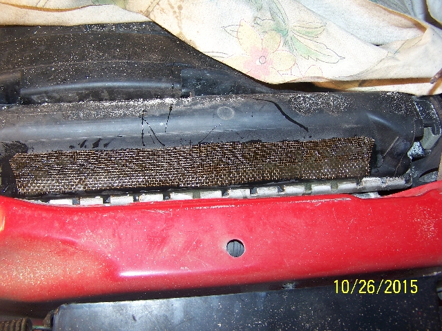

i thought most were on the engine side of the top plastic. mine is on the driver side,grill side and hidden till it got worse. now i can push it and see a slight seepage about 4-5 inches long.
ill try slight draining to dry it. then sand blast and epoxy with wire mesh.
that worked on a car years ago so we will see. ill get pix and post asap.
if no go i need advice on a good rad. my main concern is the tranny cooler quality so im relieved that i actually have an outside leak!

Default 1st try
heres the first of three layers of epoxy and mesh. test soon. i gave it 4 hours to set up
im temp on dial up so? might not get pix?
i might buy one,oem, just to be ready!

well this time not so good. still smell it and loose a little.
im struggling on what to buy, all alum or gm oem. how do i know its real gm and is it better than my old one? i see alum for $150- $500,,,?
my main concern is the tranny cooler reliability in the long run and i hear the gm is good there even with the crack problem?

I had the same problem 6months ago. I applied an epoxy patch that lasted about 2 months but it eventually began leaking again. I wound up putting in an OEM replacement radiator but I added some soft foam along the top of the fire wall where the radiator can flex and come in contact. So far it seems to be doing well. There's still some flexibility for the radiator to absorb shock but it's somewhat limited so it can't come in contact with the firewall anymore.
