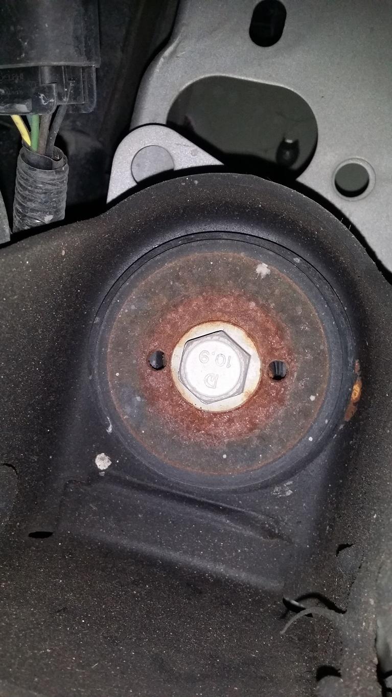

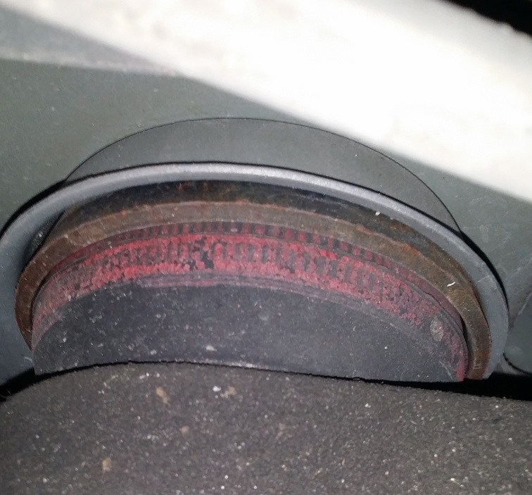

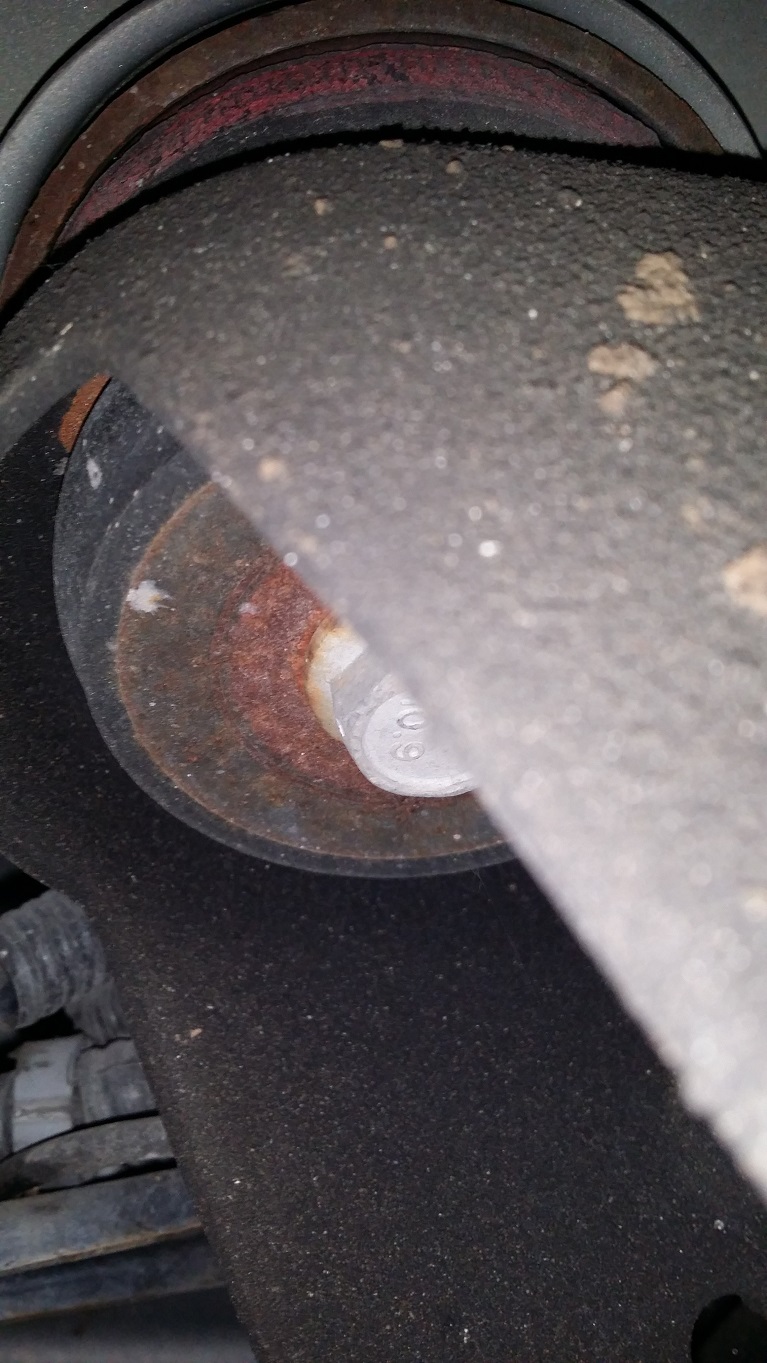

As you guys know, I just got an 09 H2.
I have some symptoms I want to fix, but I'm not sure where to start.
1. The steering wheels shakes, both when I drive & am idle.
2. I am getting some side to side shaking when going over 65 mph. (stock tires @ 40psi 305/60R20; 58 psi felt good, but harsh & that's too hard on the suspension & tries).
3. I feel vibrations (and hear them) through the vehicle. Lowering the PSI in the tires helped a bit, but not enough to provide a smooth ride.
I don't see anything specifically wrong under the truck. It doesn't look like oil has leaked from either the CV joints or the shocks. The rubber grommets on the front & rear shocks are dry rotten & cracking. Same with the rubber shock absorbers between the frame & body.
The H2 has shocks & not the air ride system. About 107K miles on it.
Here's some pics of what I was talking about. You might notice, there's black stuff all over everything, like creosote. It's dirt, but I've never see anything like that before.
Shock absorbers between the frame & body:

I plan on replacing the shocks, even though they still seem ok (I never replaced the shocks on my 03 & it always ran well). Tie rods will get replaced too as they seem rusted, like everything else.
I think moving to 17s & KO2s will fix my wobble issue, but I'm not sure about the overall ride quality & shaking steering wheel.
Thoughts?

Your body mounts look fine, I would say that the 17" wheels and BG KO2, and new Bilstien shocks will definitely fix your problem. I recently bought an 03 Tahoe and I got a deal on some GM take off 20" wheels for it. Bought new Bridgestones and it rides like your H2 now. Steering shake when you hit a bump. rough ride and so on. I am going to sell the 20's and put a set of 17" take off wheels and tires on it.
