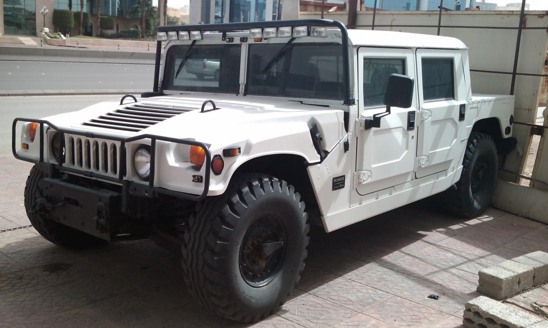

Had a quick business trip to get on and couldn't post back until today. I was out of luck the day I went, someone had taken the Wagon to get checked at a shop and so I couldn't see it. I did see the pickup, which was in HORRIBLE condition. I don't know how this person is asking this much. The interior was completely jacked, I'm talking covering up parts with standard MDF wood, the frame was bent, it leaned to one side and had a horrible paint job. You could tell the person was driving it and not giving a crap about it. Look how he parked it, rammed the gate in the back. The bumper was still sticking to it, he didn't care.

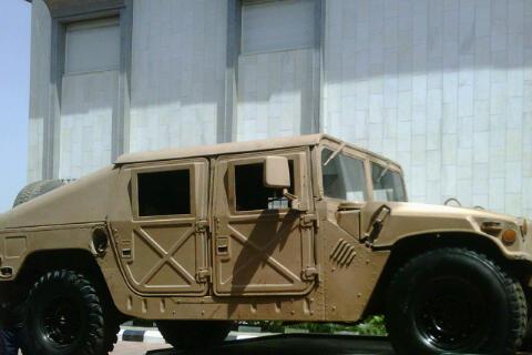

My buddy sent me a picture of a Humvee (94) and he says it's been beaten to crap, and is still pretty much military spec, no real guages. He's selling it for $17,000 USD. And the only thing that needs to be fixed is the HVAC controls on it. I'm thinking it might be a good buy because I will be abusing it without worrying too much about it now. Where as if I bought a mint condition for a high price, I'd care about hitting a sign post or other vehicle.
I've attached pics of them two and will hopefully see the Wagon which might be in better condition.
