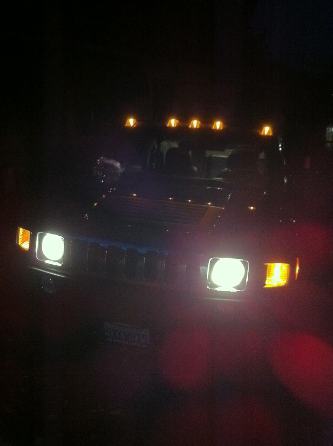

Slash x's Avatar
Joined: Aug 2010
Posts: 47
From: San Diego
Originally Posted by tate2326
slash X, can you post some pics of what that light kit looks like and how much does it cost?
Sorry for the delay. Was out of town for business
Here's a picture of the running lights at night -- still haven't taken a day time picture yet. This picture is with my cell phone so pardon the lousy resolution
Old Dec 13, 2010 | 09:22 AM
tate2326's Avatar
Joined: Dec 2010
Posts: 90
Default lights
that looks sweet. Have you had any leaks? did you rig them to come on any time your headlights are on, or do they come on with a switch like fog lights?

Old Dec 13, 2010 | 10:41 AM
NIUPonyBoy's Avatar
Joined: Oct 2009
Posts: 170
From: WI
It sounds like he just tapped into the wires running to the tail lights, so when the lights are, so are the new marker lights.
