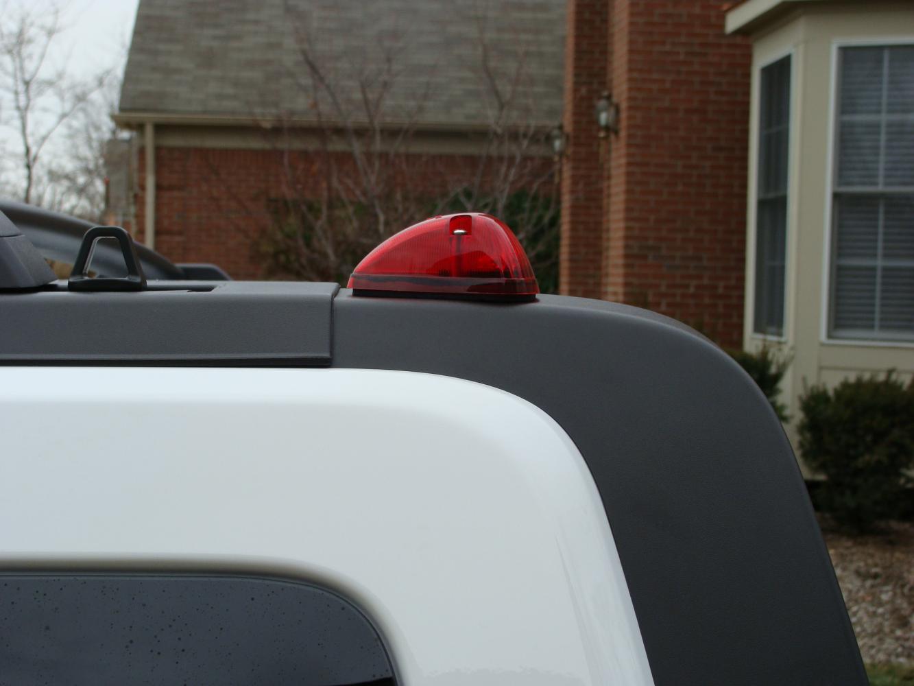

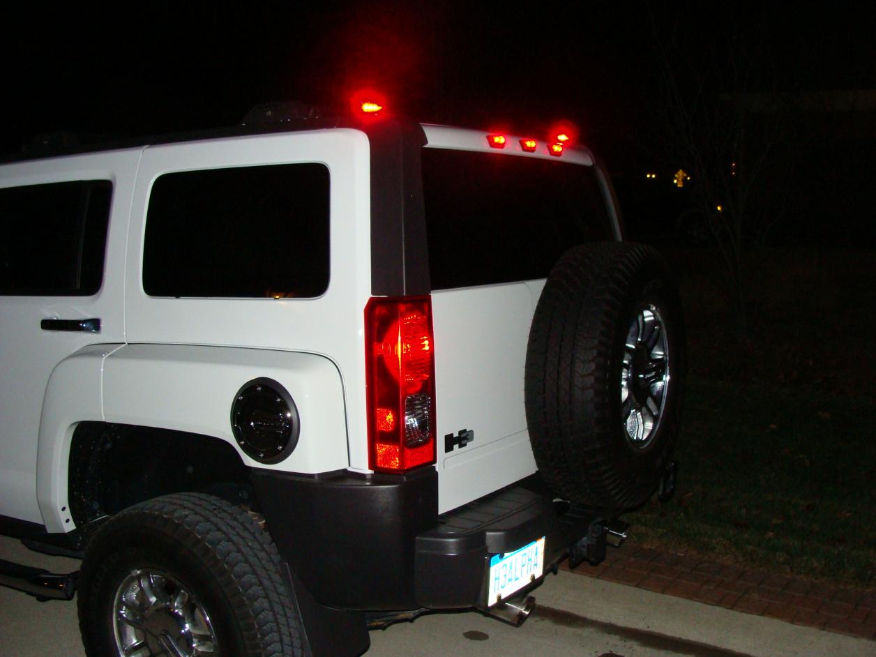

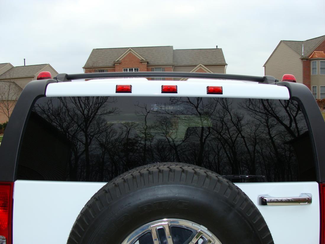

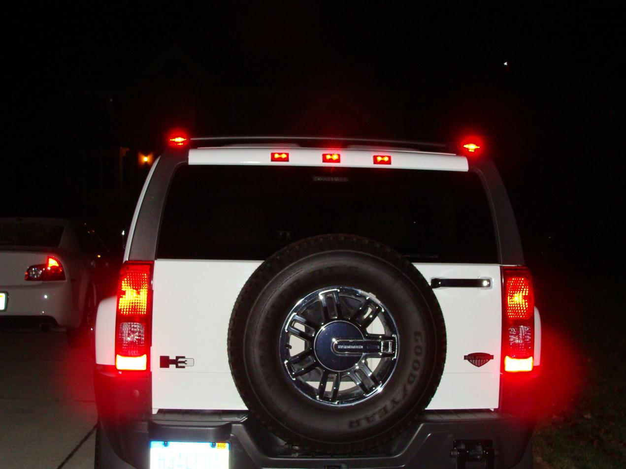

Did the fronts a while back, but hadn't found rears I was happy with till now
Attached Thumbnails Finally added my roof rear marker lights-dsc00609.jpg   Finally added my roof rear marker lights-dsc00610.jpg   Finally added my roof rear marker lights-dsc00603.jpg   Finally added my roof rear marker lights-dsc00607.jpg

What kind and where did you get them from? Looks good, DIY set-up?
Old Dec 5, 2010 | 03:44 PM
Broken Halo's Avatar
Posts: 1,461
It was all DIY. The 3 center lamps are: TruckLite model #15250R http://www.truck-lite.com/webapp/wcs...3715&langId=-1
The mounts for them are: TruckLite model #00809 http://www.truck-lite.com/webapp/wcs...3951&langId=-1
The 2 corner lamps are: Weldon model # 5060-7000-10 http://www.weldoninc.com/PDFs/PDF_Ca...rker_Lamps.pdf
They are all LED's, and total cost was about $55

Looks really good, how were the centers to install?
Old Dec 5, 2010 | 05:12 PM
Posts: 1,461
Mounting wasn't bad, but running the wires turned out to be a pain in the a$$. Each mount needed (2) 1/8" holes for the screws, and I drilled a 5/16" hole to run the wire. I thought I could feed it in, and it would follow across the top of the door and down the hinge side, where I could fish it out from the jack storage area. They kept hanging up somewhere in-between the inner and outer panel, so it took a lot of effort to finally get them through. That was probably the most time consuming part of the whole project.

How did you treat the metal where you drilled through?
I live in the salt/rust belt and fear rust as it will appear anywhere in moments.
Old Dec 6, 2010 | 05:32 AM
Posts: 1,461
Doesn't get much worse then here in S.E. Michigan.......silicone!

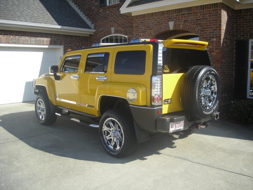

I thought I would share another option, although I know most of you folks would not be interested in having a wing on your H3. It is a show vehicle. I do not even drive it in the rain, much less, off road it. "Different strokes for different folks," I guess. I can tell you, at night it is the most lit up vehicle on the highway.
The rear corners are actually H2 corners turned backwards. Looks good and works like a million dollars. The wing has a big LED strip all the way across that lights up the whole back of the vehicle. The LED taillights are super bright. That is also a light in the receiver hitch which is wired to the brake lights.
Actually, I realize it is way too much for most of you guys but just wanted to share a different approach to rear lighting. Have a great H3 day!
