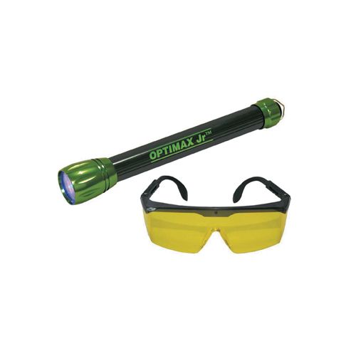

If it is wet on a dry day, then it appears to be the condenser. Do you have goggles and a uv light?

I think I have the goggles still from years back..
