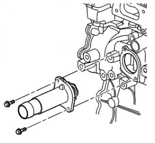

I should have been more clear in my response when stating BOTTOM of radiator when i mean LOWER radiator, as in you are not changing the thermostat from under the hood, you must remove the wheel and wheel lining to access the LOWER side of the radiator where the rad inlet hose is located. in no way do i make up answers on this forum and before you call someone out you should find out where the thermostat is located for yourself on an H3.
Fig. 29: View Of Radiator Inlet Hose & Thermostat Housing
Courtesy of GENERAL MOTORS CORP.
2. Raise and support the vehicle only high enough to access the thermostat housing (4) through
the wheelhouse. Refer to Lifting and Jacking the Vehicle .
3. Remove the left wheelhouse liner. Refer to Wheelhouse Panel Replacement (Front) or
Wheelhouse Panel Replacement (Rear) .
4. Position the J 38185 to the clamp (3) in order to remove the radiator inlet hose (2) from the
thermostat housing (4). See Special Tools.
Old Jul 15, 2012 | 03:05 PM
Posts: 9,042
I purchased the t-stat with housing, $23.00 shipped new from amazon.. ACDelco 15-11073 OE Service Engine Coolant Thermostat Housing.
Thermostat Replacement
Tools Required
J 38185 Hose Clamp Pliers
Removal Procedure
  1. Drain the cooling system
  2. Raise and support the vehicle only high enough to access the thermostat housing (4) through the wheelhouse.
  4. Position the J 38185 to the clamp (3) in order to remove the radiator inlet hose (2) from the thermostat housing (4)
  5. Remove the thermostat housing bolts.
  6. Remove the thermostat housing from the engine block.
  7. Clean and inspect the thermostat housing.
  8. Clean and inspect the sealing surface of the engine block.
Installation Procedure
  1. Position the thermostat housing to the engine block.
Notice: Refer to Fastener Notice.
  1. Install the thermostat housing bolts.
Tighten the bolts to 10 N.m (89 lb in).
  1. Position the J 38185 to the clamp (3) in order to connect the radiator inlet hose (2) to the thermostat housing (4).
  2. Install the left wheelhouse liner.
  3. Lower the vehicle.
  4. Fill the cooling system.
  5. Inspect all sealing surfaces for leaks after starting the engine.
