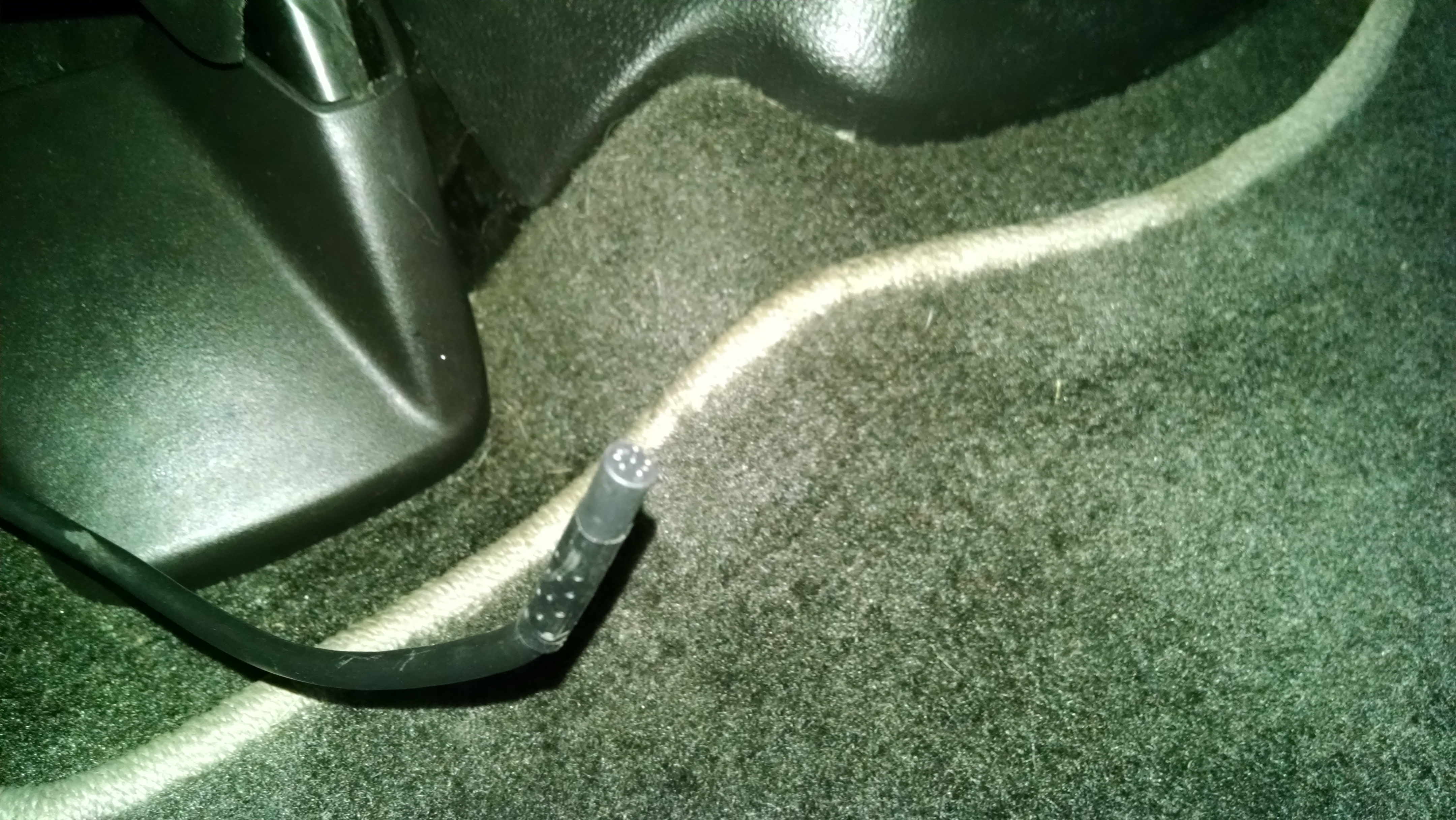

Took the drivers rear seat cover off...all good. I traced the two wires. Why the ever routed them the way they did one will never know. It is going into the seat slide track and simply pulled out. I have the end with a connector on it. New problem is this wire is connected to something on the bottom of the back of the center console. The wire that pulled out of the connector will go into this console about 5". So now I will search on how to remove that. It does not look like fun!
Old May 13, 2016 | 06:17 AM
hummin along's Avatar
Joined: Apr 2016
Posts: 74
Pic of wire end. Should be an easy fix once I figure out the console removal.

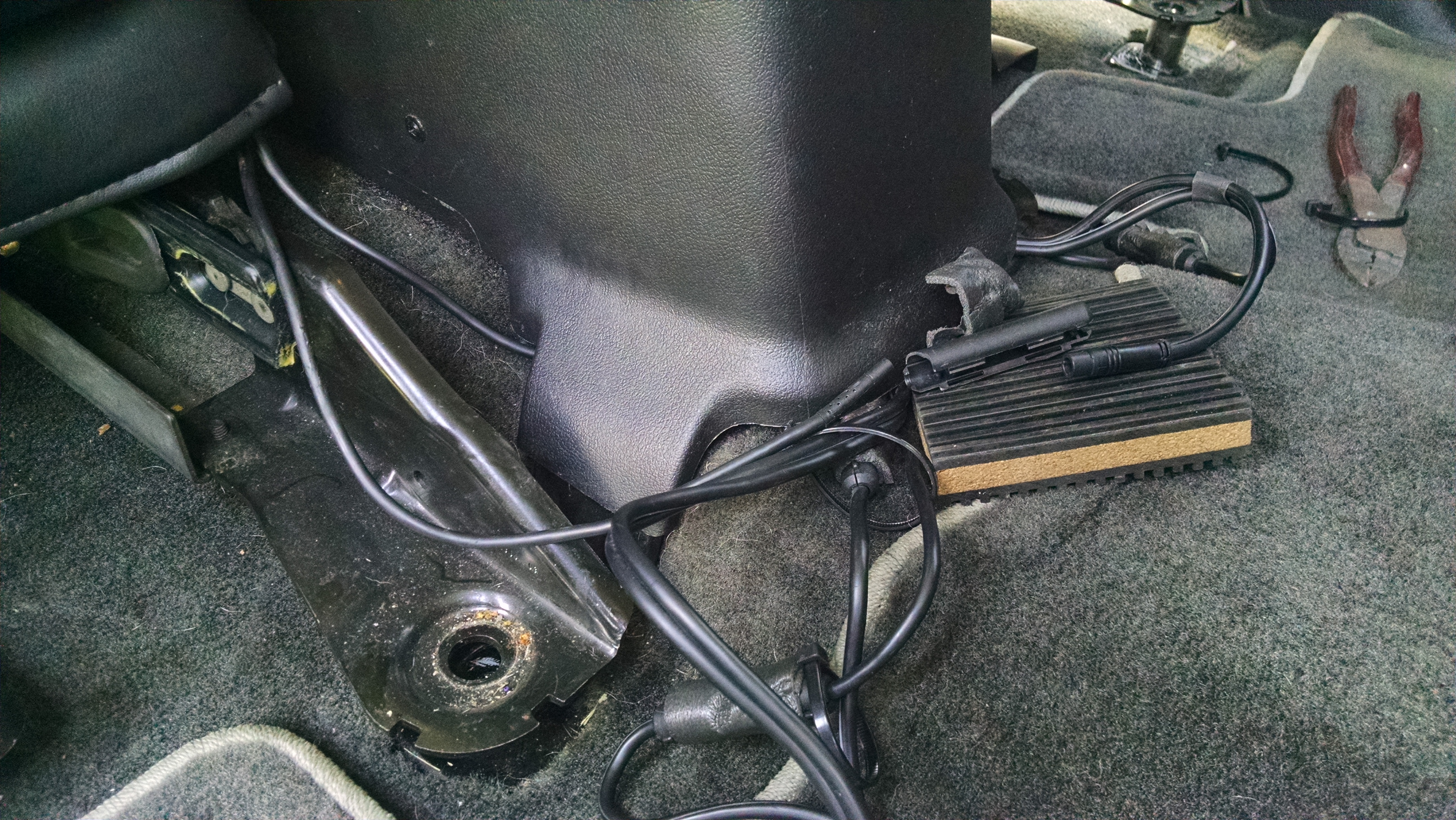

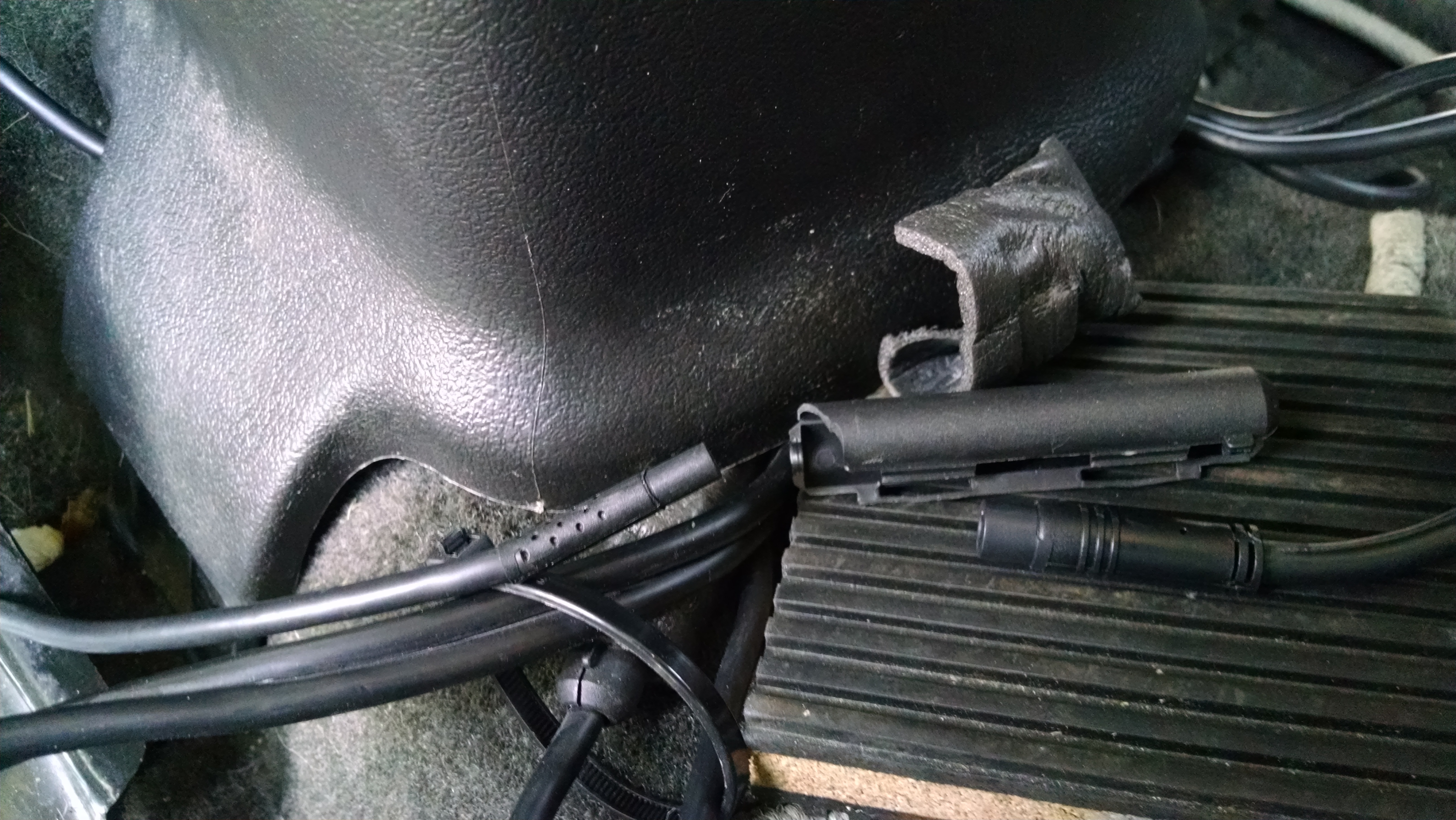

Fixed!
I just took out the rear bolts holding the seat down, reached in under the console and pulled out wires. Because GM decided to run the wire in my electric seat track, when someone wanted the seat as far forward as one could get it......it pulled the wires apart. I simply just reconnected and both DVD players worked perfectly. All this was done WITHOUT removing the console. My first sticky!
