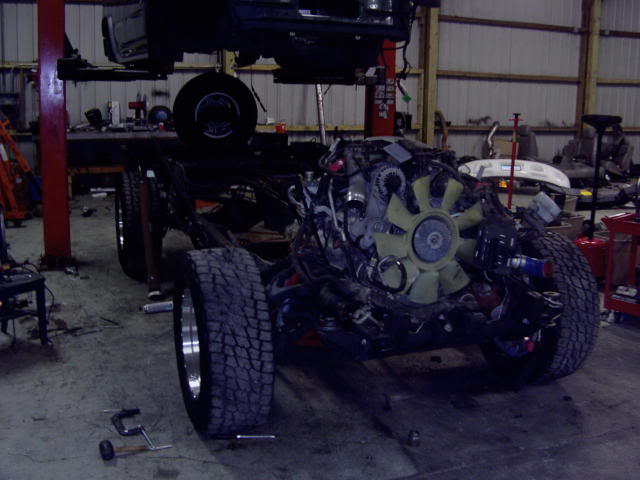

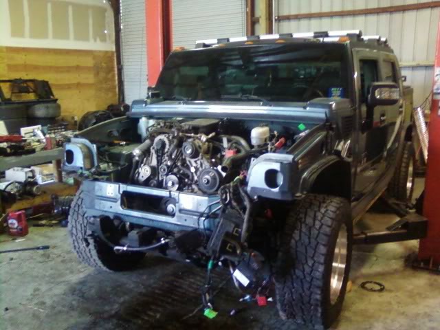

Engine in

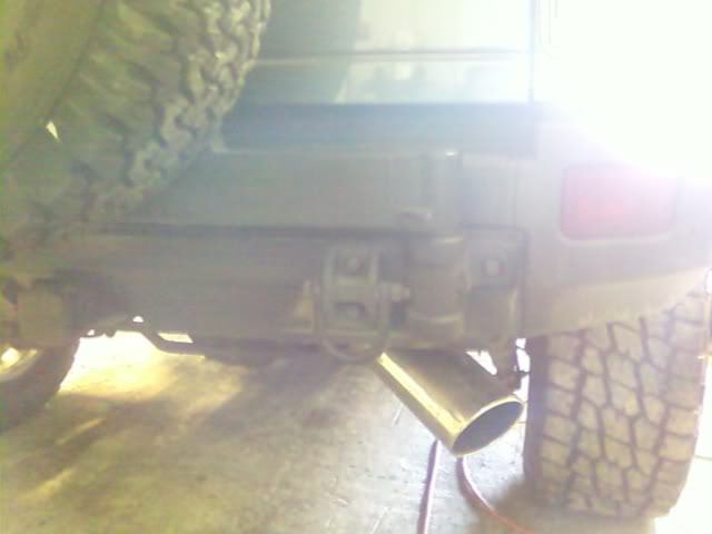

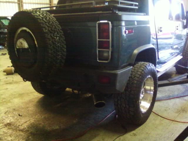

drive shafts in and on to exhaust and fuel
The client is a car dealer and wanted to keep the factory exhaust & emissions but said do what we felt was appropriate, (never tell a builder that). But he loves it

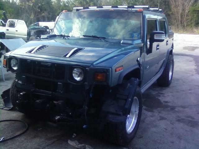

Body back on and on to cooling

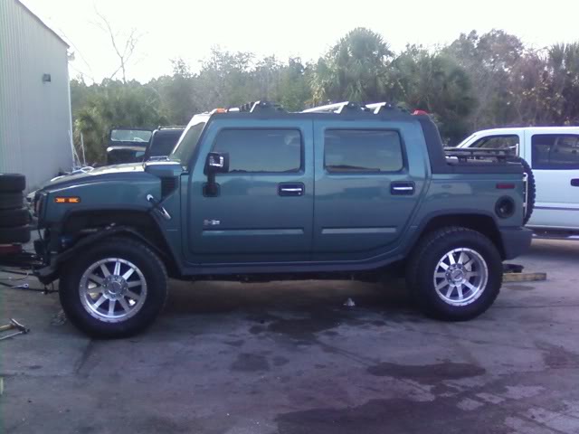

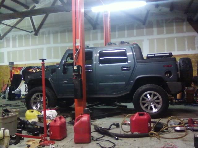

Our Stance is still stock

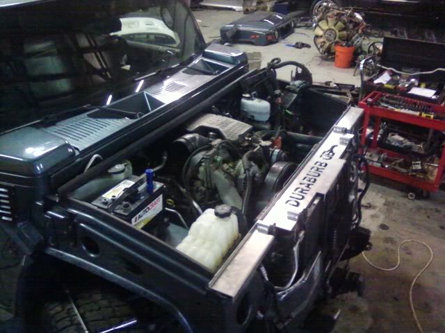

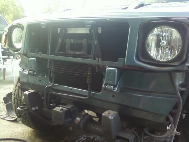

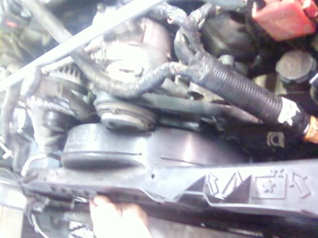

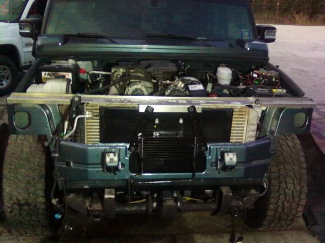

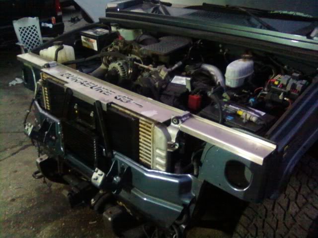

getting the cooling system to fit was tough to say the least, much worse then a V8 S-10. The radiator and intercooler are to tall to line up with fan and fan shroud so we notched out the core support and fabricated a new top and bottom support, this allows for a "fully" shrouded cooling system.
The engine bay is 2" shorter then the conventional SUV or P/U so fitment is tight but it works.

The engine is "bolt it" but the trans cross member top plate is modified. I have an agreement with sales and others in the shop that I'll post these builds but not get to carried away with trade details. This dose show you can do this yourself but it ain't easy. We do lift all of our SUV's in a fashion we have coined "Reverse Rake" meaning we lift the front and taper it to the rear, this has a two fold effect as it retains the stock level stance with the added weight and lines the fan up with the factory H2 fan shroud, the Allison fits on its own in any of our SUV builds.

So this was the final fitment before the hood, you'll notice everything looks stock and is placed & fastened in the same conventional manor as GM would typically do

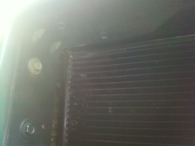

Take note of the front of the support, we worked a "raised lip" to get the much needed real-estate for the A/C core, this also adds to the rigidity as the hood will swing off this panel and we don't want it to get flimsy on us.

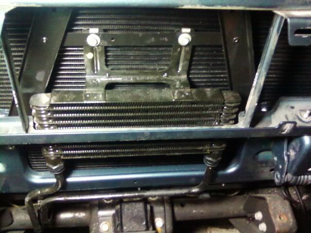

HOOD ON
Notice the oil cooler notch
We did have a issue with the A/C core being to high into the hood opening, so we had to fall back and punt so-to-speak by pulling everything out and lowering the core 1/2"Name:  9c1192aa.jpg
here is the finished product roughed out
