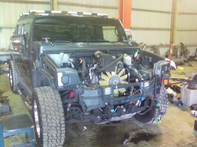

Now our client in for heart surgery, a pristine 2006 H2 SUT.
This will be an interesting build to watch, I dion't think anyone has posted one before so.....

back to the shop, prelude to the body removal
