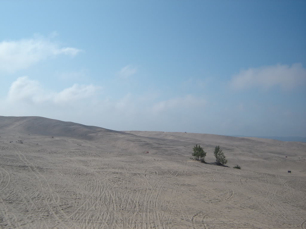

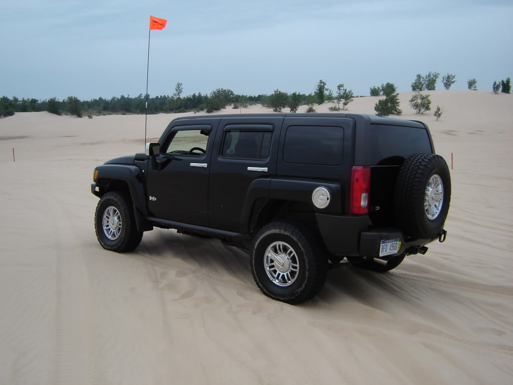

I've been in sand, Michigan has **** loads of it. Soft, fine powder, packed, wet, coarse........we got it all. I have NEVER heard of follow the track until this thread. I guess if you are in a mini van you should definitely follow the tracks?
Bald tires suck, but I do agree that most good mud tires are not good sand tires. The 33 Deulers are adequate, but they are not great either, You need flotation in sand. Wide tires do great as there is no need to dig to traction like in mud, and snow for that matter. Tall tires do not help you. 35s may look sweet, but 33s with more width will run circles around the taller tire.
With a 3, just run 4 hi lock, and TURN OFF the StabliTrack. As heavy as the 3 is, it does pretty dang darn good in sand, and with real tires, it can go anywhere you want. I can go anywhere with the stock Deulers, just takes a little more finesse.
