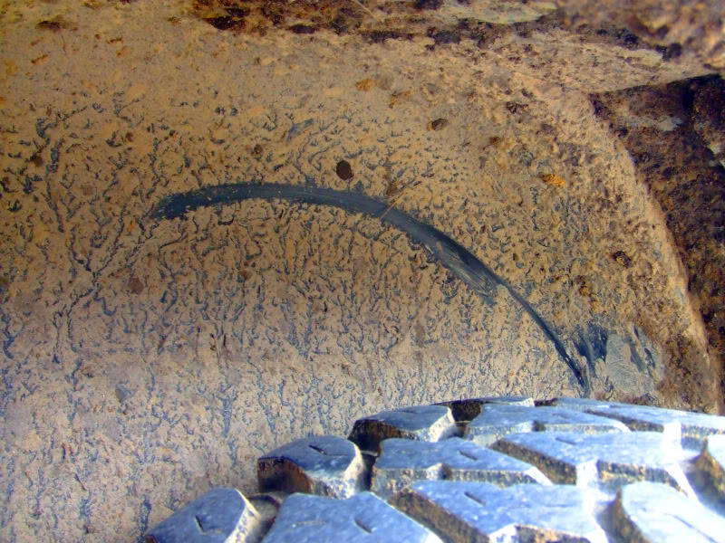

Well, I asked the question b/c I'm being told by 4WheelParts, DiscountTire and others that 295 or larger will rub in situations when offroading. For example, in this situation (compression & mild turning):
The front driver wheel will be rubbing on the fender.

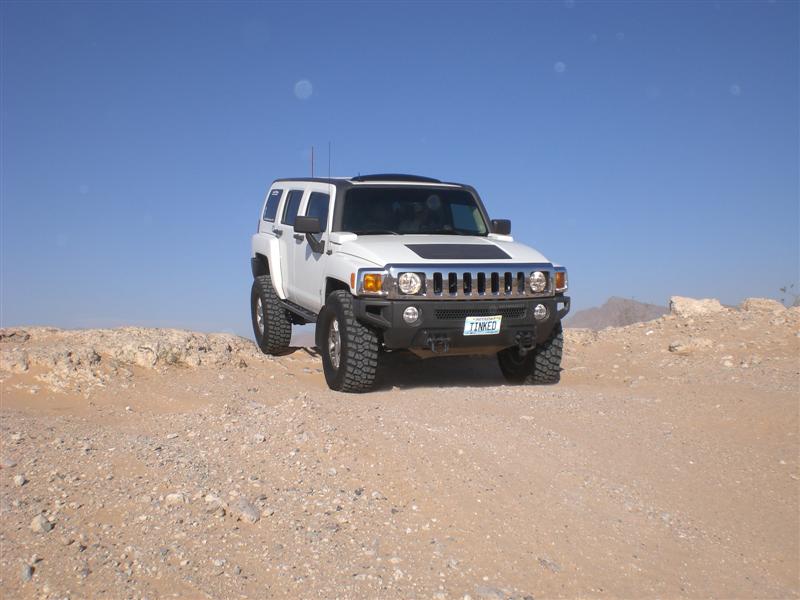

35's no problems at ALL !
NO it would not. The tires will rub, on the sway bar only, if your are making a HARD (wheel turned to the max.) turn.
I've never heard of 35's rubbing on the fenders.

Interesting, b/c out at the off-road park this Saturday I met a guy with 35's and his wheels rub the inside of the fender liner upon full compression of a shock.

Only in the rear fender well do my 315s slightly rub when it is stuffed and the other side is fully flexed. It's no big deal!

Mine only rubbed the swaybar at full hard hold turn. I added 3/8's spacers to all four wheels and that fixed that. I have had mine in some pretty good off canter situations and have never seen or heard mine rub fender wells. Crossing a creek I opened my door and it was a almost 5 feet to the ground. looked out the rear passenger door and step bar was almost touching the ground. I have leveling kit on front of mine and metric 35's. Doesn't look like the rub mark on the fender well in the picture was very bad? Barely touched? I wouldn't worry bout it no more than that and how often will you be in a sever off canter situation???
