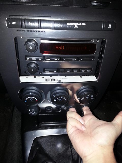

Start by shifting to neutral because you will need the clearance followed by disconnecting your battery (or at least the negative lead). Next insert your fingers into the power outlets like so and pull in an outward + upward direction.
Next, loosen the the four screws to remove the A/C controls OR you can simply unplug the harness connectors. I left the airbag harness connected because I'm paranoid, then I put the entire trim on top of the dash and out of the way.

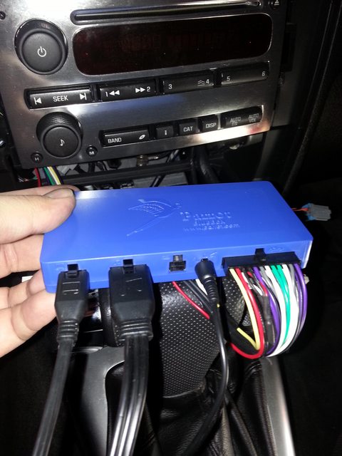

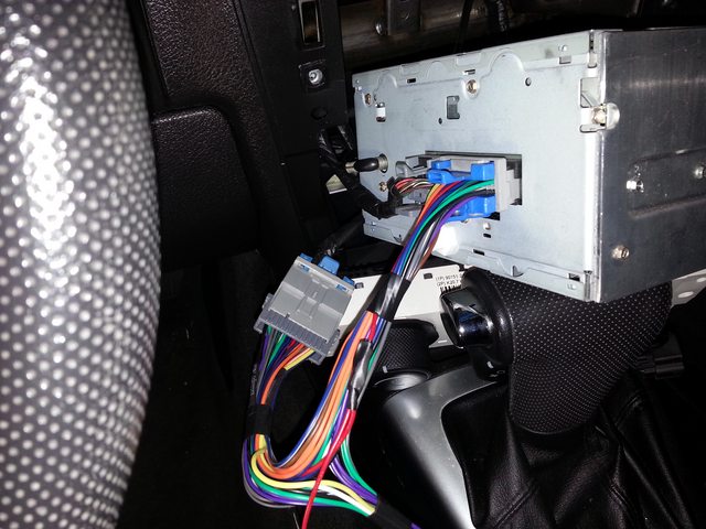

Next, remove the four screws the holding the radio and be prepared to catch it! Disconnect the big plug at the back and connect one end of the GM-2MKi wiring harness to the radio and the other end to the H3's factory harness. The single red wire will need to be connected to a switched 12V circuit. The third connection (black ISO) goes to the parrot module.
Next, prep your parrot by connecting the ISO connector, mic, display, aux/usb cables. Tuck the parrot module in there nice and neat and don't worry, there is tons of space for it.

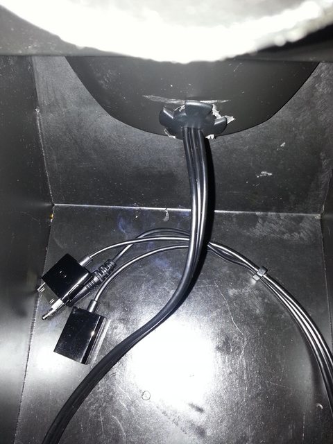

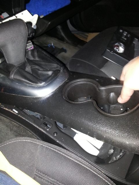

I routed my aux cables to the inside of my armrest but you can put these anywhere. Some people just leave them in their glove box. Get a firm grip on the cup holder and pull up with all your might and it will pop out.
Next, make a hole in the inside of the armrest and route your aux cables. I believe I'm missing a storage container that goes in there .

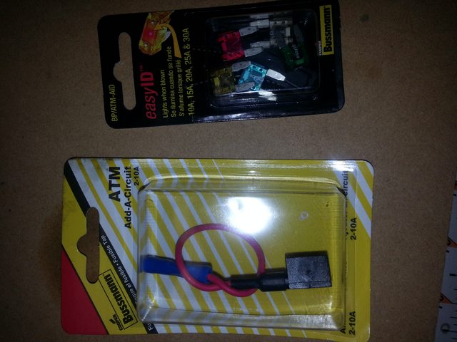

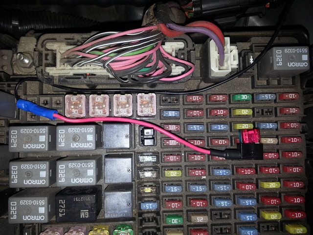

Next, get your 'Add-A-Circuit' and install it in your fuse box.
I grabbed power from fuse number #33 which is ign#1. Simply extend and crimp the red wire from earlier (I ran mine through an existing hole in the firewall). Eventually I'll go back and pick one that is hot when the key is in ACC mode instead. I just didn't have the time to hunt it down. If someones knows which one it is please share!

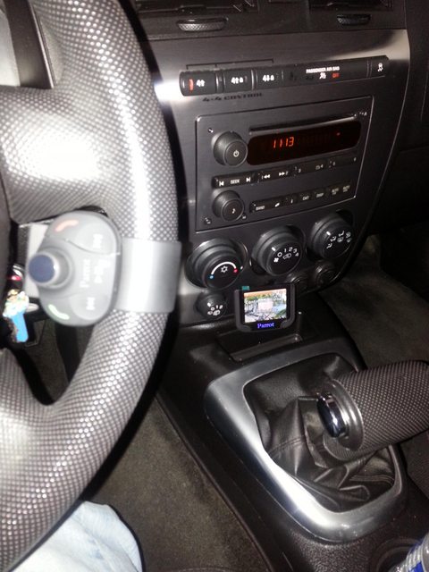

Next, I installed my steering wheel control and LCD display. Again, you can install these where ever your heart desires!
With the shifter in Park the LCD display gets blocked but I don't care. I find myself hardly ever looking at it. When you get a call it verbally says the name or spells out the number that way you never let your eyes off the road.
